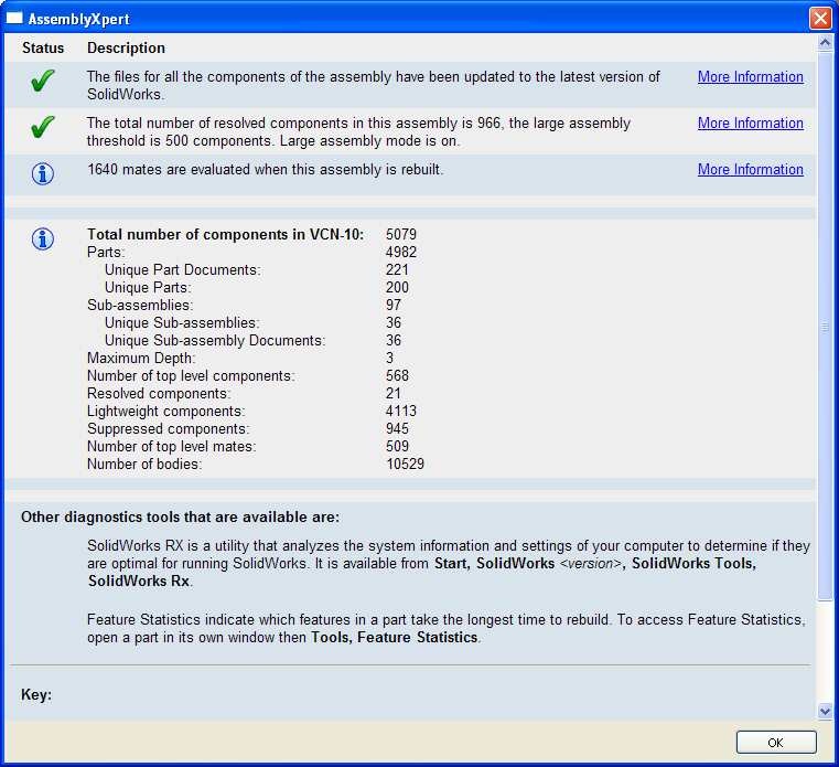

Hello guys,
I am new to the forum but have been suing SW for a few years now.
The longer we use SW the more complex our models seem to be getting. The problem is it now takes up to 5 mins to open some large assemblies and when it's open its a case of hiding and suppressing parts until its workable. I am just wondering if we are going about large assemblies wrong as everything is on a server, nothing is worked on local. When we started using SW it was ok but now there are 6 of us at times, its starting to become head ache!
also I am wondering if our hardware/OS is up to the job as we are still using xp 32bit on Dell T5400 Xeon E5420 4gb (3GB switch enabled) DDR2 1500FX or 1700FX cards.
Is it worth going win 7 64bit? It's SW2009 we are using at the moment.
Hope someone can shed some light on working large assemblies!!
Cheers
Mark

When you say large, how large do you mean? Can you post a pic of the assemblyxpert so we can see how many features etc you have. It will always be slower working off a network. You should also have 64 bit, and more ram. ( I too only have 32 bit and 4 gigs ram, unfortunatly).

Mark, with regard to working over the network, a simple test would be to Pack & Go a large assembly to a local area and see if it opens quicker. We use Workgroup PDM which pulls all of the required files from a secure vault into a defined local area on your PC....
64-bit software is also probably the way to go....
I also know what you mean about models/assemblies becoming more complex over the years. Sometimes it's just laziness on engineers part when they do a Save-As and just suppress or hide the stuff they don't need
Ray....

Sorry I should have attached a AssemblyXpert image.
This is one of the largest to date but I am sure they will get bigger.

First thing is, it is said that you should avoid having more then 300 top level mates. Use more sub assemblies if possible. On an assembly that size you need 64bit and at least 8gb ram.

A local copy opened in 30 seconds as opening over the network took just over 1 min. I cant do a true network test right now as I am the only one on the office using solidworks, its much slower when we have multiple users.
It seems that PDM works is the way to go.

One more suggestion I would have is to check the level of detail on non-essential parts such as fasteners, screen, expanded metal, etc.  Also, transparent parts can slow things down quite a bit.  I worked an assembly once where a designer included one piece of perforated plate- it cut the performance of the entire assembly by 1/2.

For reference, I've attached a AssemblyXpert report from one of our larger projects.
I opened the assembly with everything resolved (nothing lightweight and Large Assembly Mode disabled).
System is HP Z600 (Xeon X5670) running Windows 7 64bit with 12 Gig of Ram.
Load time from network is around 2:50, load time from local drive is 1:20 (minutes:seconds).
Since upgrading to 12 Gig of ram, I am now able to work in large jobs without having to use large assembly mode or opening just the lower level sub-assemblies.  I can now load the entire job into memory and then open and work in the appropriate sub-assemblies.  Since I don't have to continuely close and reload sub-assemblies all day, the slower speed of working from the network is less of an issue.
I would definately recommend upgrading to Windows 7 64-bit and more memory.
