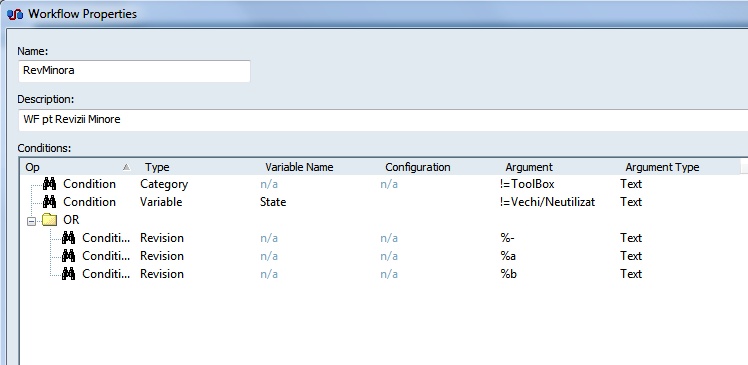

JG 2010-05-25 Best Answer
I think you are missin the OR condition:
comment imagecomment image

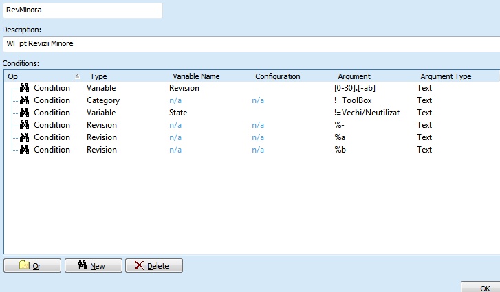

I try something like in attached picture but it doesn't work. I really don't understand what is problem.
I resolved my problem with a dispatch admin action and now user receive a message that the file revision is 0.c and must do a major revision.
