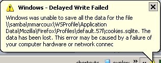

I routinely get an "Windows - Delayed Write Failed" (see attached) error when I use SW2009 or SW2010.  It usually happens or occurs after I've been working in SW for a couple of hours.  Has anyone else experienced this?  We've been unsuccessful in diagnosing what causes the error.  When we get the error, we have to save over any files that we may have open, and restart our workstations to make it go away.  Any suggestions?

What is  Firefox doing while you are running SolidWorks?
MM
MM 2010-08-16
Firefox is open and running.  We use a web based email program, so it's usually always running in the background.   Do you think there is a conflict?
AW
AW 2010-08-16
Mike,
I would look at that.  The error message doesn't look like it has anything to do with SolidWorks.  When you restart your computer you are also re-starting the application that you are running that uses FireFox.
You do not have a confict with SolidWorks.  It is between FireFox and Windows or the Linux Samba server your profile looks to be stored on.
Might work with your e-mail client and FireFox turned off for a day to see what happens.
Cheers,
Anna
MM
MM 2010-08-16
Thanks Anna,
I'll try your advice.   There does seem to be something that is happening outside of Solidworks that is "competing" for the same resources.  On a side note, and in doing a little research and debugging, we did discover that my virtual memory and page file size was set at half of what it should be.  This may not be the source, but it's interesting to note nonetheless.  The assemblies we were working on were quite large, so there could have been a problem with the cache getting too large.
Regardless, thanks for your advice!  Next time I'm in the assemblies, I'll be sure to have Firefox closed to see if I can replicate the issue.

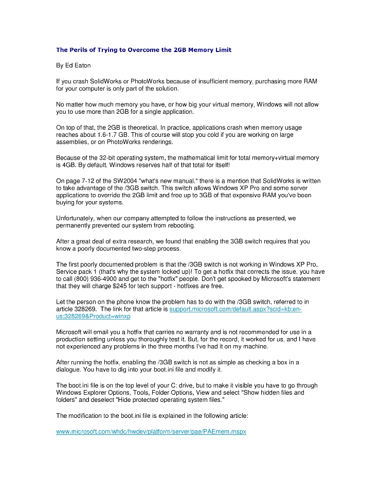

If adjusting the VM helped and you are running a 32 bit system, you should consider enabling the /3GB switch.
