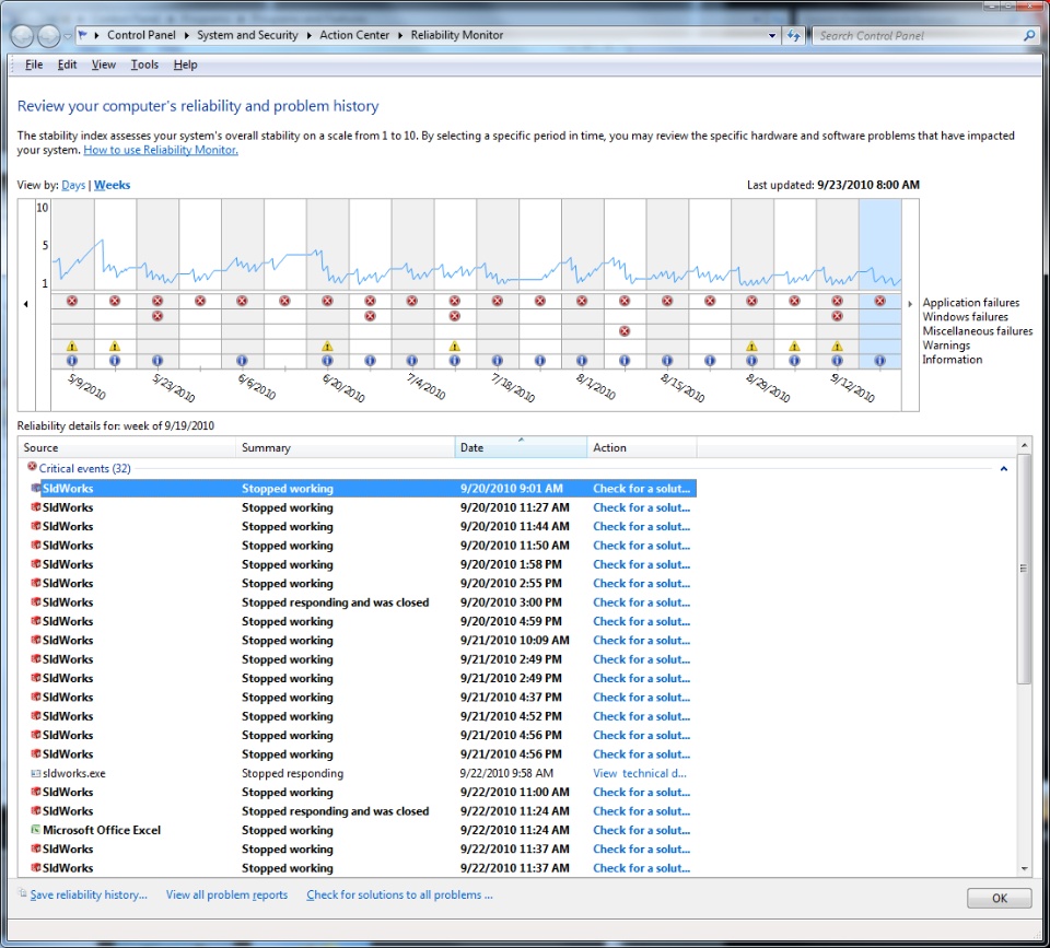

I'm running SW2010 SP4.0 on Win7-64 on a Dell T3500 with a quadro fx1800 and 6gig RAM.  Bug full or bug free? Take a look at the attached image, and judge for yourself...
I've contacted my VAR on this, and because they cannot reproduce the crashes, SW will do nothing.  I've done everything they've asked - disable virus prot, work on local files, disable all add-ins, repaired excel, reinstalled graphics drivers, ect. None of it is the source.  I just hope they get this sorted out with 2011, but I seriously doubt it.
