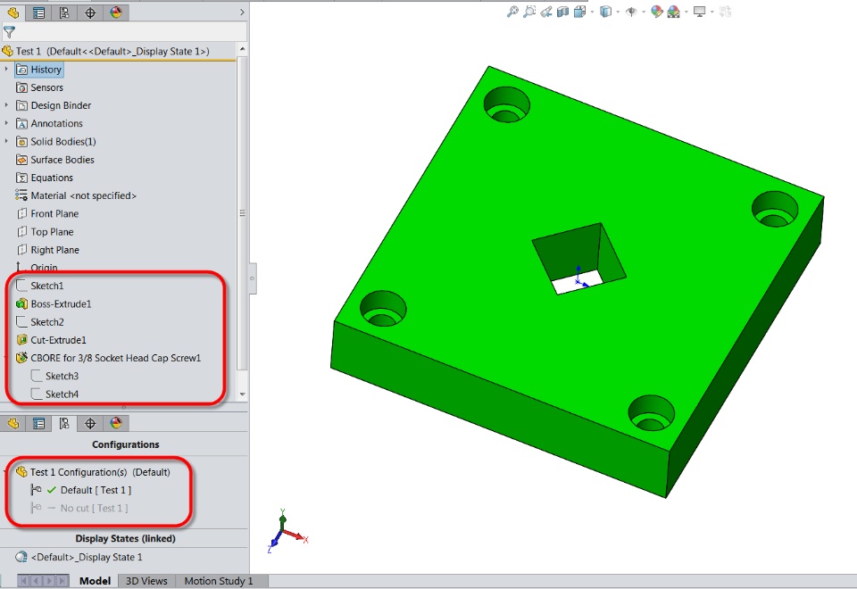

2. Download the PDF of the model you need to create (attached). The SOLIDWORKS 2017 model was also attached.
3. Start with a default Part-inch template. You can have the origin and the 3 planes.
4. Position the camera to capture your screen, keyboard and mouse interactions.
5. Using only the keyboard and mouse, build the model, using the features shown in the video.
Cut-Extrude1 is suppressed in the No Cut configuration.
All sketches are fully defined
Use the minimum number of dimensions, no more than 3 (three).
6. Post your raw video and the SOLIDWORKS file in this thread as an attachment, or as a link. Please indicate if your entry satisfies the rules for the Visual Contest. I would appreciate if you would include your time, as per your calculations.
7. Do not use macros or library features.
8. The timing will be judged based on your video timeline:
  • The clock starts when you perform the interaction (keyboard or mouse) on the opened part.
  • The clock stops when you finish configuring the part with all features presented.

​ (or ​), I have watched the video a few times, and I cannot seem to spot the moment you apply the equal relation to the lines of the square. How did you do that?
I like the modeling speed. I do not like that the two squares have independent dimensions. If anything, I would accept for the inner square to be an offset of the outer one.
The whole model should be controlled with only 3 dimensions, not 4.
Is it too much to ask you to re-record the video following this rule? I am OK with the extra square contour, since I specified that the user has some freedom on constraining the holes.
Hope you would not mind.

Hi Alin,
Definitely makes sense to re-record with the offset dimension rather than having the hole pattern independent. I suspect it will add an extra second or two
Regarding the square for the cutout, the reason I don't add equal relations is because it's not created with the rectangle tool but as a 4-sided polygon which has inherently equal sides. I'd like to know if that qualifies as well.
When I get time to re-record, I'll also try to do something like the IOGraph and make a list of the keyboard shortcuts used.

- If you are asking about the initial square sketch, I think that both dimensions get a "5" dimension - it happened really fast, I didn't catch it in the first couple times that I watched.
(Is this right ​? - I didn't see you add an equal relationship.)
still amazing . . .
RN
RN 2017-07-18
Hi Todd, that's right I entered the "5" dimension twice which automatically adds the equal relations with the on screen numeric input option
Same for the "4" dimension for the construction line square
The cutout square was a 4 sided polygon which is inherently equal

Technically.. there is no "Square" sketch entity..
Next time I record I'll drop the "cheap tricks" and stick to the pure interpretation of the rules
I had a feeling the separately dimensioned construction square, and polygon wouldn't fly. Thanks for clarifying Alin

"The whole model should be controlled with only 3 dimensions, not 4. "
I'm still digging on the 4-sided polygon for extremely flexible squares . . .

4. Free Modeling Contest  - judging the modeling proficiency:
  • have to generate the same geometry and configurations, with no restrictions on the type of sketch entities or features
  • have to use maximum 3 dimensions to constrain the part (not including the hole sizing)
  • have full freedom on the use of the interface

Are you faster than your machine?
Compete against attached macro.
DD
DD 2017-07-24
Here is my attempt at the visual portion of this competition, hope I didn't break any rules.
DD Speed Bump - YouTube
Keyboard was limited to A, S, ctrl, number keys and enter. Mouse was limited to right and left mouse keys.
I hit the front plane at :10 and changed the configuration at 1:41 for a net time of 1:30. I know that doesn't put me in first but if I'm not dq'd, I'm on the board!

<p>Dave Dinius wrote:</p><p></p><p>Here is my attempt at the visual portion of this competition, hope I didn't break any rules.</p><p><a class="jive-link-external-small" href="/external-link.jspa?url=https%3A%2F%2Fyoutu.be%2FC02CM7AxZOI" rel="nofollow" target="_blank" data-community-id="1">DD Speed Bump - YouTube</a></p><p style="min-height: 8pt; padding: 0px;"></p><p>Keyboard was limited to A, S, ctrl, number keys and enter. Mouse was limited to right and left mouse keys.</p><p>I hit the front plane at :10 and changed the configuration at 1:41 for a net time of 1:30. I know that doesn't put me in first but if I'm not dq'd, I'm on the board!</p>
Nice. 1:30 confirmed.
Looks like you use Mouse gestures a lot, and is hard to avoid using them, am I right?

Alin -
Here is one attempt just for "ok I did it"
comment imagecomment image
AV
AV 2017-07-26
<p>John Stoltzfus wrote:</p><p></p><p>Alin -</p><p style="min-height: 8pt; padding: 0px;"></p><p>Here is one attempt just for "ok I did it" </p><p style="min-height: 8pt; padding: 0px;"></p><p></p>
Thanks John. Would you please re-record the video and add the configuring phase?
NH
NH 2017-07-26
A serios error ocurred with macro.
Crashed soldiworks 2015sp5 2wice in a row.
JS
JS 2017-07-26
Ok - See Attached
AV
AV 2017-07-26
<p>Ned Hutchinson wrote:</p><p></p><p>A serios error ocurred with macro.</p><p>Crashed soldiworks 2015sp5 2wice in a row.</p>
Interesting. I tested it only on SW 2017 SP 4.0.
AV
AV 2017-07-27
<p>John Stoltzfus wrote:</p><p></p><p>Ok - See Attached</p><p style="padding: 0px; min-height: 8pt;"></p><p></p>
Thanks John. Any chance to get a recording including your mouse and keyboard in the view?
Would be really nice to see you on the leaderboard.

Ok here's my go
I reckon bout 51 sec from first plane to config suppression.
Only able to use screen recorder.
2015 SP5
AV
AV 2017-08-01
<p>Ned Hutchinson wrote:</p><p></p><p>Ok here's my go<span class="emoticon_happy emoticon-inline" style="width: 16px; height: 16px;"></span></p><p>I reckon bout 51 sec from first plane to config suppression.</p><p>Only able to use screen recorder.</p><p>2015 SP5</p>
Thanks a lot, Ned. Do you have a smartphone or a camera for recording your interactions with the keyboard and mouse?

<p>Daniel Benterman wrote:</p><p></p><p>Hi Alin,</p><p style="padding: 0px; min-height: 8pt;"></p><p>Here's my submission sans baby and toddler.</p><p>not sure if its valid or not as i cut many corners. this has been a fun challenge, although 99% of the time its my brain thinking of solutions that is the delay <span class="emoticon_happy emoticon-inline" style="width: 16px; height: 16px;"></span></p><p>we should of added a drawing to the challenge, as at that stage its quicker the better <span class="emoticon_happy emoticon-inline" style="width: 16px; height: 16px;"></span></p><p>Also i wouldn't have to go so fast if i hadn't lost half my day to trying to get a podium spot <span class="emoticon_happy emoticon-inline" style="width: 16px; height: 16px;"></span></p><p style="padding: 0px; min-height: 8pt;"></p><p>i think i'm at 38 seconds on the free modelling, I've used grid snaps and a 4 sided polygon for the center hole, and im still not as quick as others, hilarious.</p><p style="padding: 0px; min-height: 8pt;"></p><p>One thing this has highlighted is that i need a shortcut to tab to positions on the hole wizard.</p><p style="padding: 0px; min-height: 8pt;"></p><p><a class="jive-link-external-small" href="/external-link.jspa?url=https%3A%2F%2Fwww.youtube.com%2Fwatch%3Fv%3D06NcVmcyi70%26feature%3Dyoutu.be" rel="nofollow" target="_blank" data-community-id="1">Freestyle speed - YouTube</a></p><p style="padding: 0px; min-height: 8pt;"></p><p>EDIT it should be free modelling</p>
Never thought of the grid. Great example, Daniel. Does not meet the conditions for this competition (need everything constrained), but is an eye opener.

Congratulations to all Winners of the 9th WPUC - "Interface in Your Face"
Freestyle (Any shortcuts can be used, but need to match the feature tree and sketch constraining scheme):
  1. : 0 minute 33 second
  2. ​: 0 minute 34 second
  3. ​: 0 minute 37 second
  4. ​: 0 minute 58 second
  5. ​: 1 minute 30 second
  6. ​: 1 minute 41 second
Visual Contest (Presentation Mode):
1. ​: 0 minute 42 second
2. ​: 0 minute 45 second
3. ​: 1 minute 29 second
4. ​: 1 minute 30 second
First video posted, that meets all Freestyle requirements:
1. ​ - 1,000 points
Free Modeling Contest (Any sketches or features can be used, any shortcuts could be used):
1. : 0 minute 29 second
5. ​: 1 minute 14 second
6. ​: 1 minute 30 second
7. ​: 1 minute 41 second
Free Modeling - The New Generation - Contest (First video posted, showing a user completing the challenge while holding a baby):
1. - 5,000 points
Now, it is time to start the debate. What did we learn from the videos recorded by these power-users?
