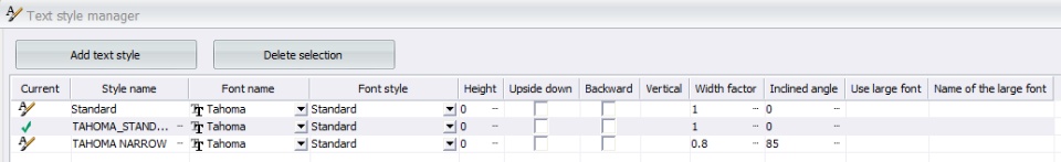

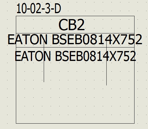

I created a "Narrow" text style with a width factor of .8. I assigned that style to my  #REF_REF attribute (mfg pn) for my one line symbol template because a lot of my part numbers are very long. The text style does not seem to apply in the symbol. (some properties do, like upside down, which is a checkbox.)
Inclined angle also does not seem to work.
First Eaton is attribute on symbol, second is "drawn" text
Is this a bug or am I doing it wrong?

ES 2021-04-09 Best Answer
Lynne, I have tried the same as you on a few occasions and come away scratching my head on controlling texts with this feature, it's definitely needing a little more work to be consistent or useful in my opinion.  I've put in a few ER's on this with SW, I'd suggest you do the same based on your experience!
