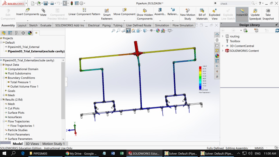

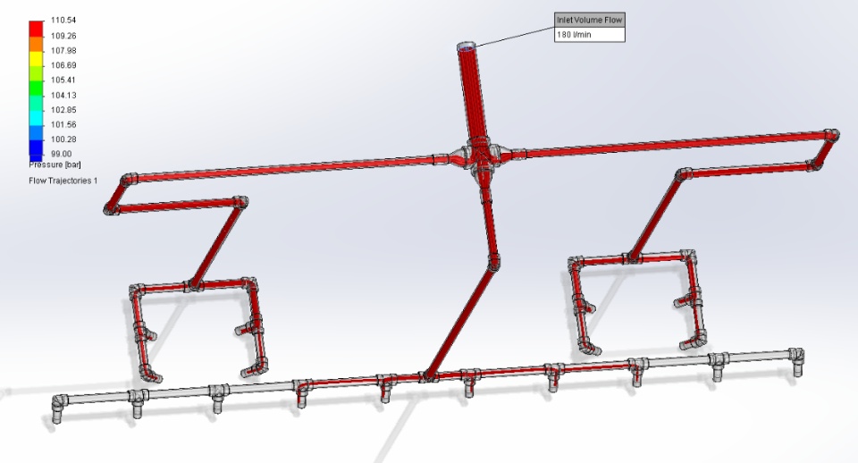

Below are some of my simulation trails, I have tried Internal Flow simulation with different inlet volume flow rate and also external flow sim.
1st Trial:  Internal Flow simulation
Inlet Volume Flow Rate = 180 L/min          (since there are 18 output)
Output Pressure = 100 bar                          (in each nozzle)

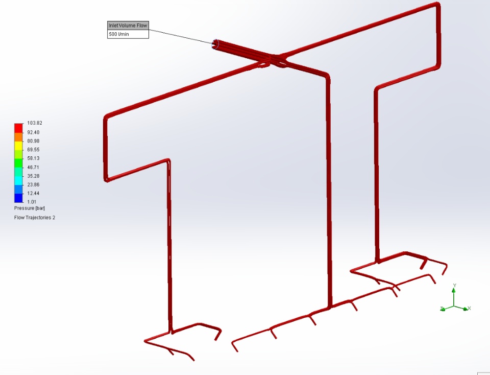

2nd Trial:  Internal Flow simulation
Inlet Volume Flow Rate = 500 L/min
3rd Trail: External Flow simulation
Inlet Pressure = 110 bar
Outlet Volume Flow Rate = 180 L/min (in Total)

There is the notation of each nozzle output.
These are the simulation result.
I don't understand why the calculation showed "SG Volume Flow Rate 5 = 11.7726 l/min", but the nozzle 5 does not have water coming out in flow trajectory.
