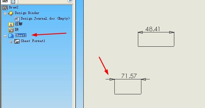

Why Ubound(GetAnnotations)=0 in Sheet Format?
Why
In Sheet Format1
    GetFirstView  →  GetFirstDisplayDimension→ ubound(GetAnnotations)=0
Why
in Sheet1 view
    GetFirstView  →  GetFirstDisplayDimension → ubound(GetAnnotations)>0
In Sheet Format1, GetFirstView  →  GetFirstDisplayDimension5 → ubound(GetAnnotations)=0
