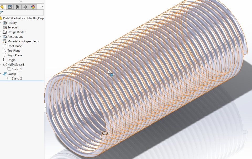

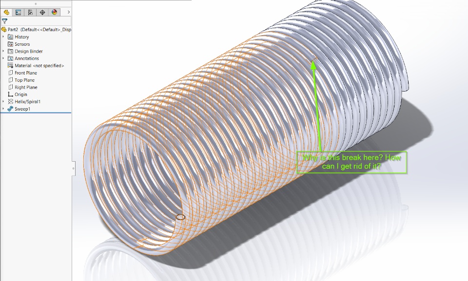

I want this tube coil model to at least appear to be continuous for the purpose of having an accurate view in a drawing file. Notice how the solid body doesn't appear to be continuous.

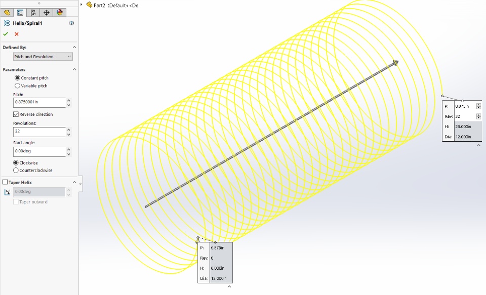

Helix Settings:

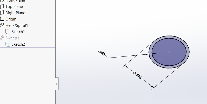

Sweep sketch dimensions:
If I increase the difference between the OD of the tube (0.875) and the pitch (0.8750001)  to something as much as 0.0001, it appears the body becomes continuous. However, I would prefer that the geometry reflect my intent perfectly (0.875 OD, 0.875 pitch).
(Note that if the OD = pitch, it doesn't appear that SolidWorks allows the Sweep function to build the body. Maybe this is due to some sort of zero-width geometry or body intersection error - I'm not sure.)

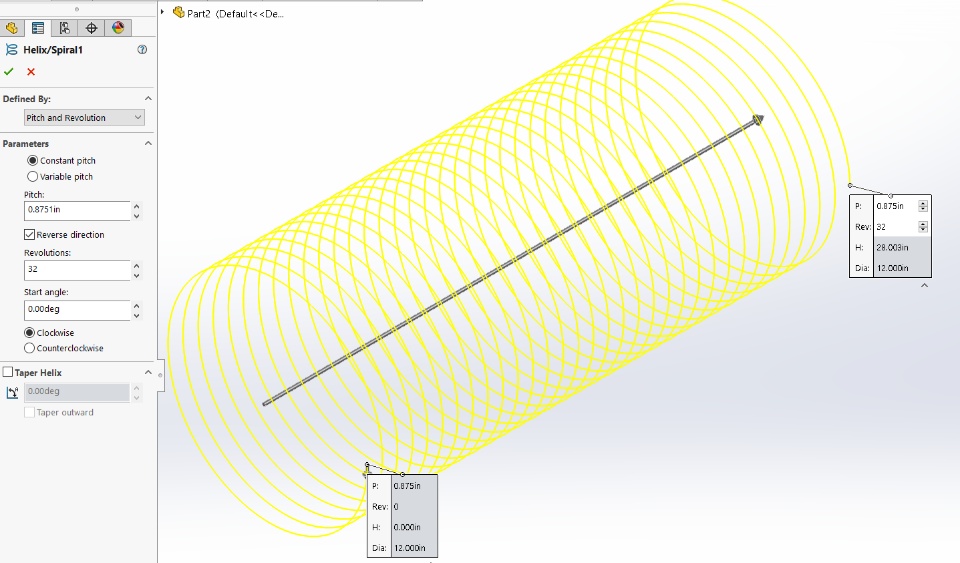

Here's the result of 0.875 OD, 0.8751 pitch:
(0.875 OD, 0.8751 pitch) Helix Settings for Continuous Body:

EDIT: If you read the thread, I accidentally uploaded a version of the coil file that had dimensions that did not produce the render error. I've attached "Coil Example 2 (Produces Error)" for future readers. This one has the pitch set to 0.8750001 in, which produces the render error. Moving the trailing "1" to the left by one order of magnitude (0.875001 in) makes the error disappear. Thank you for understanding.

Try increasing your image quality settings.  See if that takes care of the issue.  If it doesn't then the issue is more than likely the fact that the algorithm for creating the geometry is rounding off some numbers and that edge is the result
The other thing to try is to do it with a sweep with a straight line for the path instead (and a specified twist value).  See if that gives you a different result.
In the attached file I have a path length that is simply the OD of the tube * 32.  Then I put 32 revolutions into the sweep.  It seems to work great and is continuous.  Takes a while to rebuild, since each revolution actually touches the previous one.  SW 2017 file attached.

I opened your Part and rotated it every which way and don't see that edge.  It might just be a graphics glitch on your machine.  Have you tried inserting a drawing view yet?  It might not show up there.  If it does, I know this might cause some people to break out in hives, but you could hide it there and ignore it in the model.

I assume that you are talking about this seam:
Yes...I hate that as well.  You may need to increase your pitch a little to get away from that.  When a body intersects itself, Solidworks automatically creates an edge there.  I don't know of another way to go about it.
In my model, if I change the length of the straight line to be .875*32.0001, then there is no seam. And there is a measurable gap between the coils of approximately 0.00007mm.

Glenn and Tony: I just downloaded the .zip I uploaded and I had the pitch at 0.8751, and that does not manifest the render error. The render error isn't manifested until the one is moved ten millionths' place, at 0.8750001. That is my mistake for not double checking the file before I uploaded it.
I went to a different workstation on the LAN and opened the same file and the render error was reproduced.
For now I will just leave it at 0.XXX001, since that does not produce the render error and my assembly isn't that sensitive anyway.
