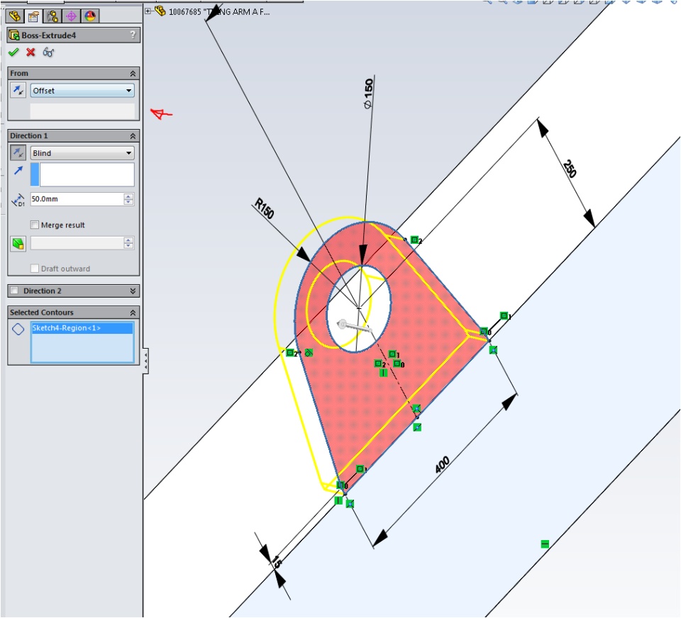

Why is offset grayed out when I try to extrude a sketch at an alternative position ?
I have a sketch that I am going to extrude.
The sketch is however located on the edge, but I want the extrude to be place some distance from that edge. To place the extrude at the correct position I use  the offset.
BUT
The field for offset is grayed out.....and cannot be filled in.
Is this a bug or what ?
Reg Einar
SW /PDM 2014 SP5 / Win 7 SP1
SolidworksParts And Features

DG 2015-03-24 Best Answer
Not sure about exact reason but try restarting SOLIDWORKS or your system and try again.
If the above doesn't help then the file may be corrupted or this is bug reported under SPR #: 720242

Einar,
Don't you need to select the surface or face from where you want to offset from?

<p>John Stoltzfus wrote:</p><p></p><p>Don't you need to select the surface or face from where you want to offset from? </p>
No, there is no need to do that

I guess this is the same as SPR #: 720242 as you mention.
Several of our user have seen this and it is anoying like .... yes you know.

I've had this problem a lot.  Most often, turning ON Options, System Options, Performance, Use Shaded Preview fixes it.

SF 2015-07-10
This fixed it for me (SW2014 SP5.0, Windows 7).  I didn't even have to restart Solidworks.  I changed the setting and it just started working.

GW 2017-11-17
I came here looking for a solution to the same problem.  Sadly and pathetically, your suggestion worked.

MM 2018-07-03
Thanks! Cured my problem - SW 2017 SP5

SF 2019-08-20
Had the same problem, but somehow this fixes it (2017 SP5). That's a weird bug.
