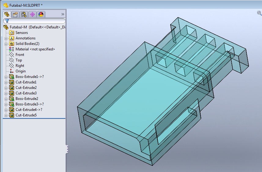

I was making a part in an assembly, right clicked it to open just the new part, and it's transparent. I've had this before and someone told me it's because of the material setting, but I didn't set a material (I never do), and 99.9% of the time opening a part by right clicking doesn't turn it transparent. So far I've blown over 45 minutes trying to figure this dumb little thing out.

Try expanding the solid bodies and the display pane to see if it is transparent there.

I'm not sure if they were transparent or not. I went to the color section, and clicked on the "remove appearance" button, which did the trick. While everything seems to be OK now, I'm wondering how I got solid bodys to begin with. It might be something with my making the part in context with the mating connector.
