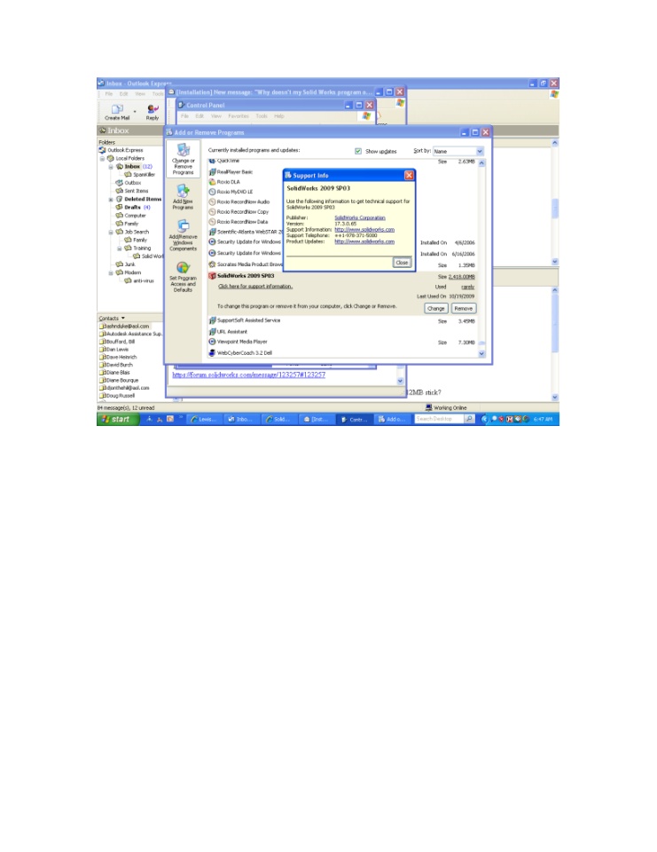

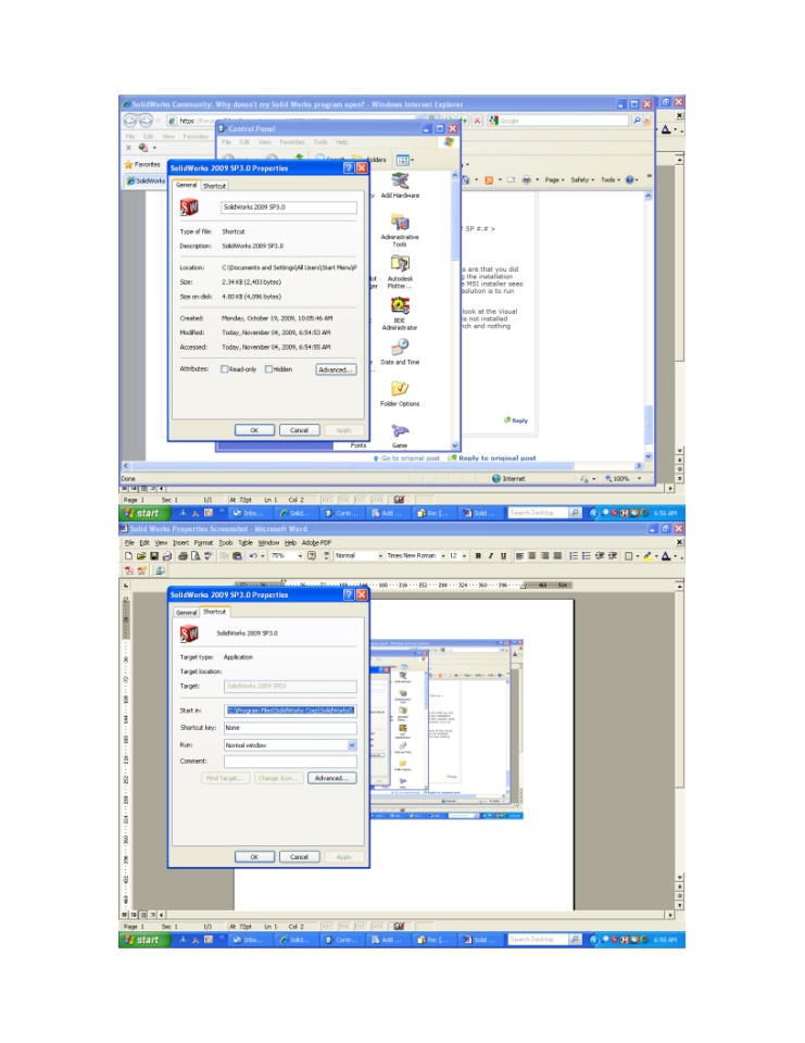

Can you post screenshots of the SW shortcut, it's properties and the install folder of SW?
