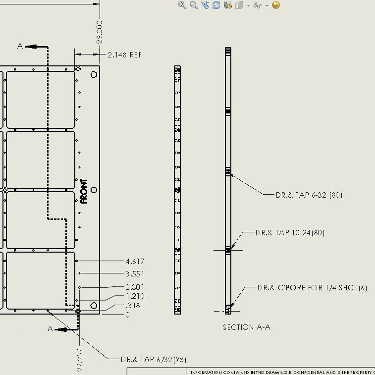

Why does Solidworks add material/length to section views?
Attached is a simple section view through a plate. Why is the plate longer in the section view? You do not ADD the length of your jog to the section! The section view should have a break line were all jogs are. Drafting 101.

Not sure what version of Solidworks you have but I believe it depends on how you create your section view. Solidworks gives options to include the cut faces and the jog faces, elongating the view, as well as doing it a more standard way and showing just the section cut and not the jogs also. Check how you created it.

Look at 2014 SOLIDWORKS Help - Creating a Section View Manually. Appears to be due to using a construction line over a solid line in the sketch.

I'm sorry, but the length of a jog should never in the section view.

The arrows on the section line represent line of sight, which is why you only jog parallel to the arrows. I'm old school. You would never add the length of a jog to a section if you where on a drawing board. Also, the jogs should not be drawn as object lines in the section view, they should be broken lines, look it up.

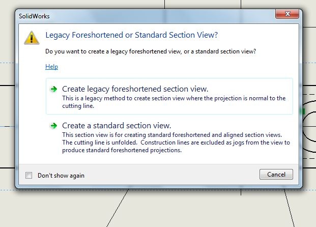

Here is what I found that nobody mentioned.
1) Sketch your jogged section  line.
2) CTL Select each line you just drew..yes one at a time grrrr... and hope SW doesn't select the centerline you have directly under your section line.
3)Select the Section view icon.
4) A window pops up and you select "Create legacy ...etc.

The legacy method in your image is not recommended unless you have a specific case where it is needed, particularly non-orthographic bends in cutting lines where results will be foreshortened in a direction not normal to the cutting line segment.  For most cases (especially those that you describe), simply start the Section tool (without drawing a sketch) and the place the cutting line on your parent view and use Section View Assist to add your jogs.  You'll be able to create section views with jogs with Section View Assist much quicker than drawing an initial sketch first.  The more jogs you have, the more time you'll save over sketching.

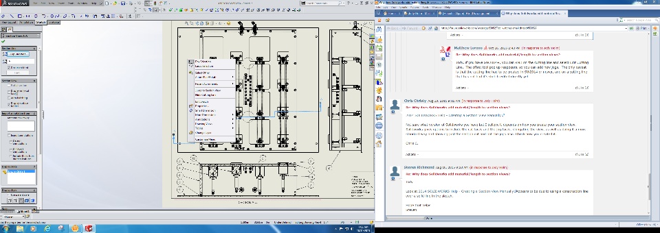

Jody, if you have SW2014+, you can RMB on the cutting line and select Edit Cutting Line.  The offset tool pop up reappears, so you can add new jogs.  The only caveat is that the cutting line had to be created in SW2014 or newer, and on a cutting line that has not had it's sketch edited directly yet.
JH
JH 2015-10-19
Matt,
I don't see anything that says Edit Cutting Line. See attachment.
JH
JH 2015-10-19
Matt,
I don't see anything that says Edit Cutting Line. See attachment. Ooops. forgot the attachment.
