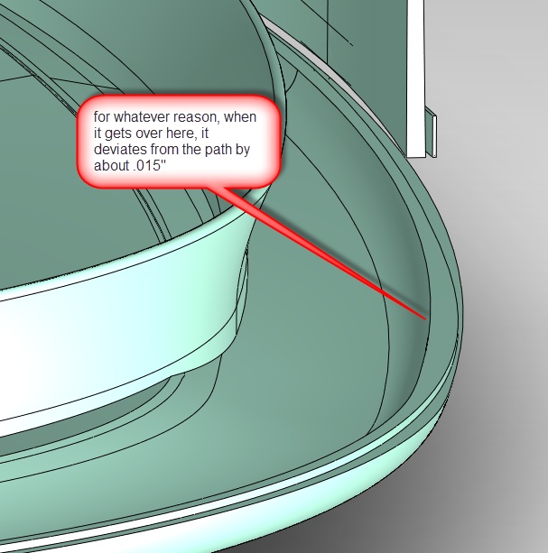

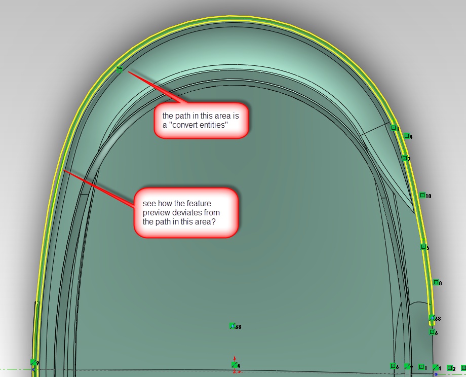

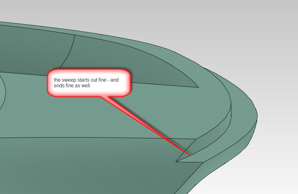

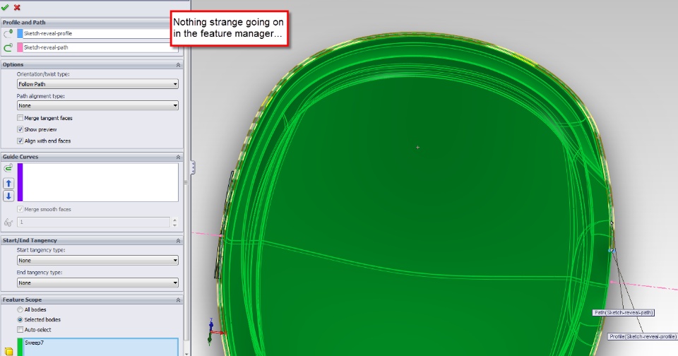

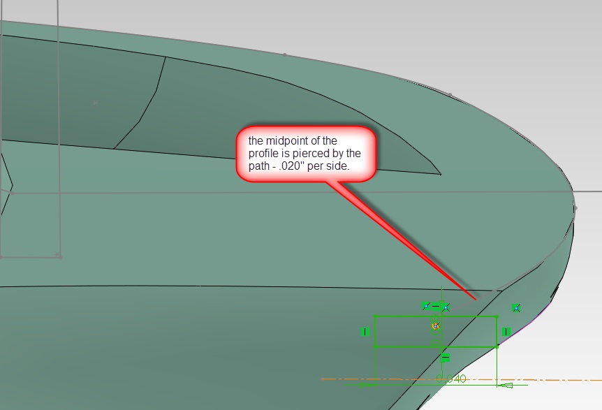

Why does my sweep profile not follow my sweep path?
Frustration:
Maybe because I am a SW newb?
Maybe because the model I am working on is horrendously patched and built without regard to stability?
Maybe because SW is just prone to errors?
I have two questions.  The first is my post subject - pretty self-explanatory.
My second is simply: WTF?
Hopefully you can see this.  Measuring the feature confirms that what you see is real geometry and not a faceting / graphics thing.

SF 2012-05-21 Best Answer
Maybe try changing the orientation path to twist along path.

Nate,
What if you were to add a second guide curve to help solidify the path.

Scott - This morning I was able to ask a user who is more experienced than me and his suggestion was the same as yours.  He claims to have needed a second guide curve many times for similar reasons.  I have tucked that away in my mind for the next time - I am not sure if I am hoping that next time will come soon enough for me not to foprget the tip, though...
In futzing with the feature last night, I deleted the offending converted entity and replaced it with a mirrored curve from the same sketch.  That works - for now.

Hi Nathan,
There is also "direction Vector" option. This option is use to overcome the issue that you are experiencing. It basically lets the user pick a reference like a plane or axis that serves as a reference in which the profile uses to keep itself normal to while sweeping along the path.
