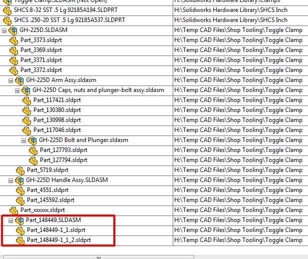

One of the label fixtures I've been working on broke. I've had a drawing of the assy and it's been opening with zero issues. Today when I started adding the component parts to the drawing (copying from the part drawing and pasting into the assy drawing) it started yelling at me about a component that's missing.
The "missing" component was modified to make it smaller (it's a base for a toggle clamp that was too high so I sliced a section out of it, separated it and joined it as an assy and put that into the rest of the model). Somehow Solidworks reverted back to old dependencies (ONLY FOR THE DRAWING, ASSY WORKS FINE!) from last week when the modified parts wasn't modified yet and now it's stuck on stupid.
In the assy, the Find References dialog shows it is pointing to the correct files (see below). So I bit the bullet and created a new drawing. When I closed the new drawing and re-opened it, it popped up the same damned message about missing components.

Thanks . Does that include extensions? The assy that I made from the two parts has the same name as the single part I split, just an assy extension. There are also a step file in there with the same prefix.
And check out the dates from these files, all from Monday.

No extension and your file names are different (I mean not exactly same since they've different suffix).
Try opening the files which SW is saying are missing and then open the drawing and see if you still get that error. Now save, close and reopen the drawing. If you again get that error, then search for the files SW says are missing in window explorer (as it usually does in case there are duplicate files).

I opened the assy for the clamp, the sub assy for the base that I modified and the two component parts that I used to make the assy, then I opened the drawing and it asked me to suppress or browse for the file, I browsed and changed the file type to all files and selected the assy, it said it could not be used...
I searched the entire hard drive and could not find any duplicates.
