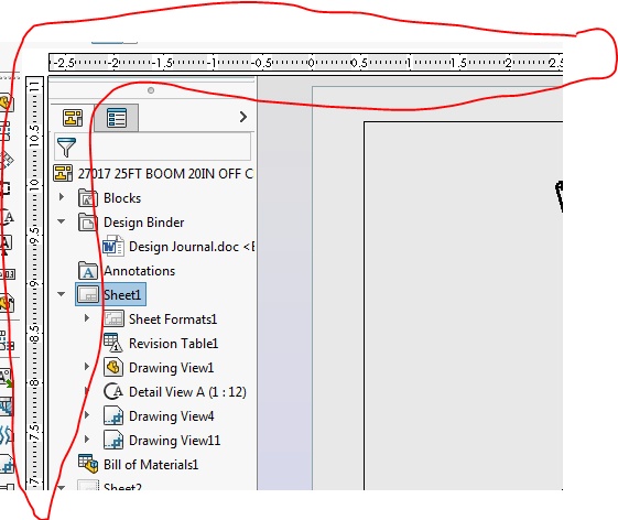

Why do my drawings (new to 2016) have ruled edges?
If there is a toggle/check box in settings, I haven't found it.
How do I get rid of these ruled edges on drawings?
Answers 3

JP 2017-07-19 Best Answer
You can turn them off here ...
comment imagecomment image
GS
GS 2017-07-19
Go to View > User Interface and de-select "Rulers".  They show up when you edit the sheet format, and usually go away when you exit the function, but sometimes they don't, so you may need to turn them off again occasionally.
