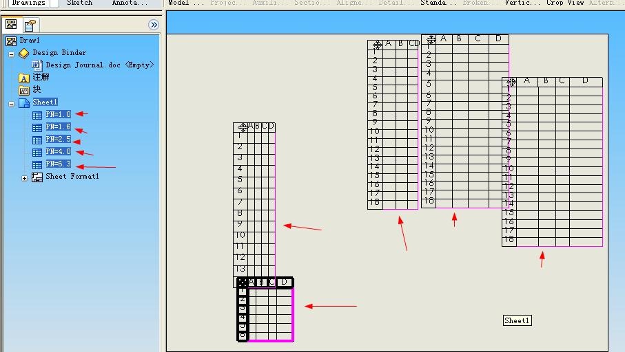

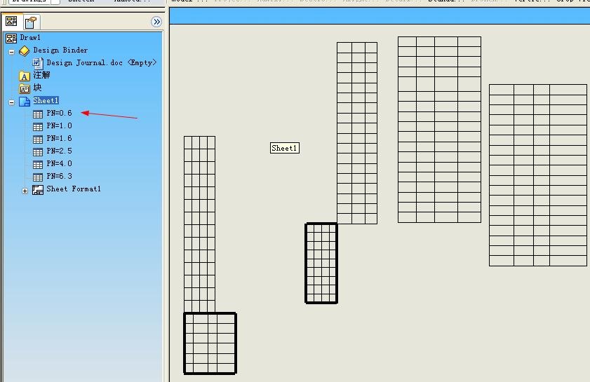

Why can only delete a General Table
SwSubFeat.Select False→
editdelete → can be delete One General table
SwSubFeat.Select True
editdelete  →  don't delete the General table
Select many Feature of GeneralTableFeature, but don't delete General table.
follow code
