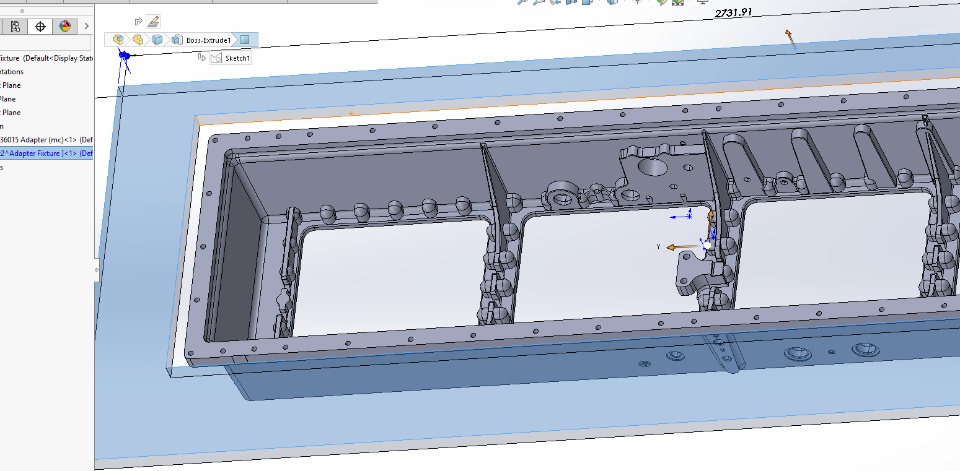

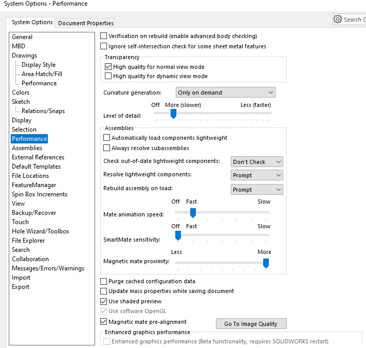

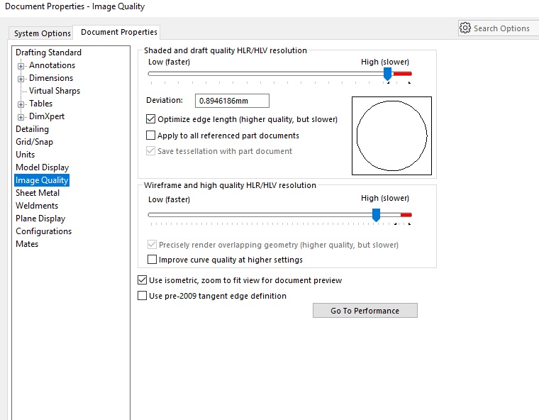

Afternoon all,
Ive just installed a new copy of solidworks on a new computer and my graphics are not looking very good at all!
Please see photo below of the part and my settings.
Graphics card is  a Nvidia Quadro P2000
Any help would be great, many thanks Matt.

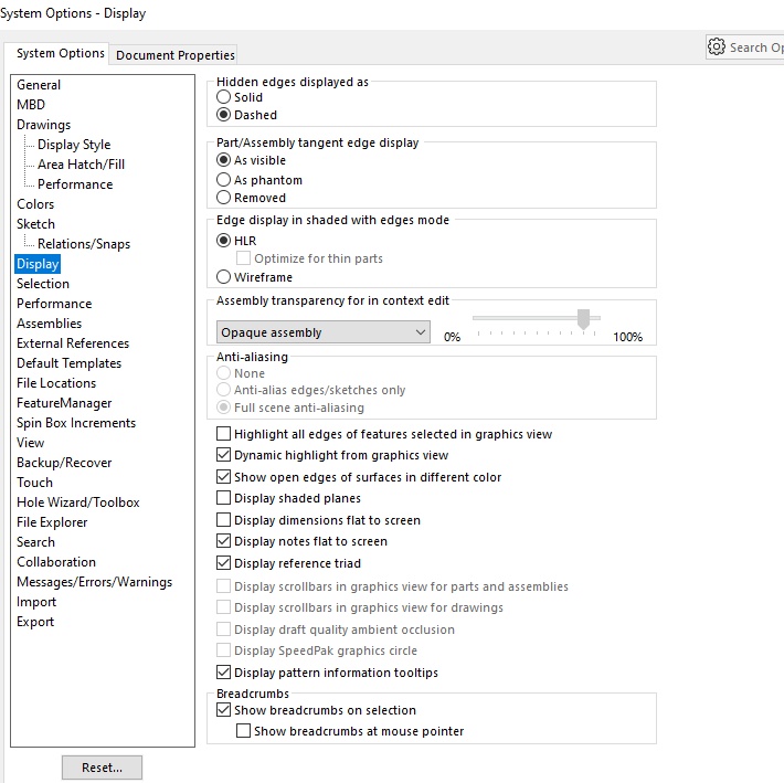

AB 2021-04-09 Best Answer
This seems to be something you'll need to set in the NVIDIA control panel. I don't have an NVIDIA card to take screenshots but I know there are application specific settings that are applied by default to SW there. I noticed a colleague's computer had the same issue and I overrode the anti-aliasing there I think and it solved the problem.

Need to close all files the uncheck.

FL 2021-04-09
That's anti-alias.
You can tune it in nVidia Control Panel.
Problem is graphic looks great with AA but drawing will look blurry.
