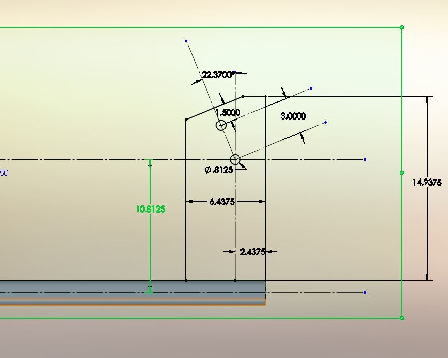

This may be a trivial question but I searched the web and couldn't find anything on this.  I recently upgraded from SW2010 to 2015 and now have noticed that when in sketch mode, my dimensions are now appearing to be boldface on the screen.  This is not a problem, more of an annoyance for me.  The fonts used to appear perfectly clear with my old version.  I haven't changed any of my proto templates so not sure why the font appearance on the screen would have changed.  My prints still come out looking clear, its just the screen.  My document font type isn't set to bold.  Any ideas would be appreciated as to what I need to change.  Thanks in advance!

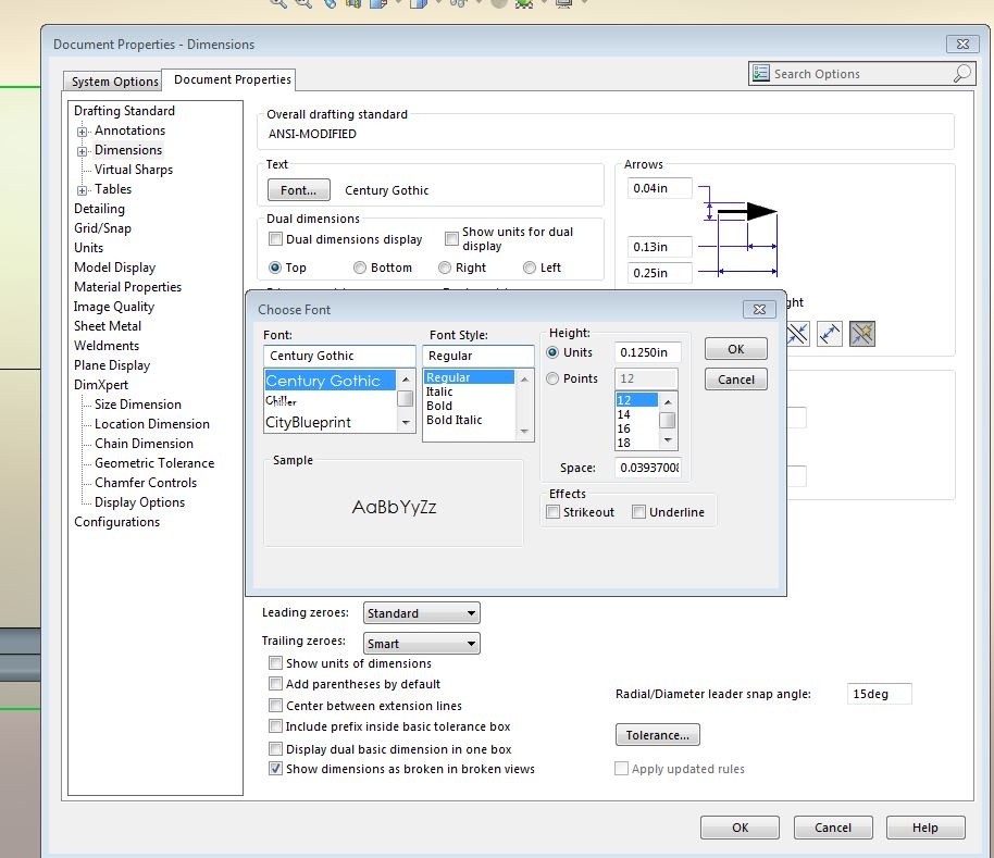

Good morning Ingvar,
I installed SW2015 while SW2010 was still installed, then later uninstalled SW2010.  I'm still running the same OS (Windows7).  From what I recall reading, as long as the fonts are installed in Windows, SW should read them fine.  I do have them installed in Windows according to what I'm seeing in my control panel under font listings.  Like I said, just an annoyance as the dims and relations appear not nearly as clear as they used to when I ran SW2010 and I never messed with any of the font settings.  Something must have changed in the newer SW versions it seems.

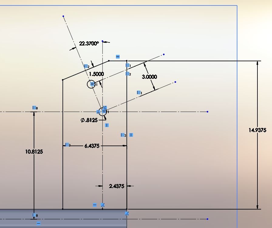

Toggle 'Display Dimensions Flat To Screen' On   If unchecked the dims show bold in a sketch.  Likely got unchecked with you new install.

That did it Anna!  Wow, great catch!  Have a nice weekend!
