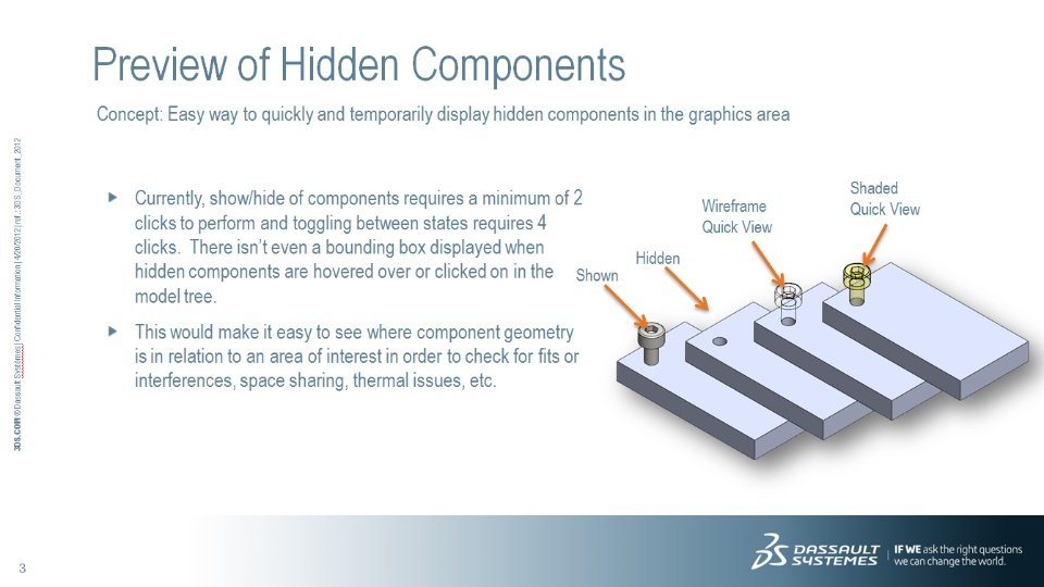

Do your users hide multiple components in an assembly and then need to show them as a reference when working with some other area of the assembly but only want to show them for a quick geometry check?  We need your input.  Would a quick preview of the actual geometry be useful?  What should the preview look like?  How should the preview be invoked?  Should there be any options associated with it?  Please keep replies limited to this subject and as always, thank you for your input!

I think this type of thing would be useful in assemblies. It could potentially be as simple as adding another display style in assemblies. When I was a designer I would always be turning components on and off to view different parts of a design, or to measure. If I were able to just hide components and then toggle a display style called Shaded with Hidden or something like that, it would've saved quite a bit of time. The alternative is to create a slew of display states to toggle between, and that could be quite a bit more time consuming- not to mention confusing.

Thanks for replying.  Yes, I agree we can already do this with an excessive amount of work on the users part.  I was a designer/engineer up until March and I was always using Isolate and Hide/Show to display what I wanted but it reuired a lot of clicks, this concept would've sped things up considerably.

from that post, I like the idea of the hide command having multiple "states" the question is, if we do that, how do we get the functionality we want in that post where the hide command lets you drill down from the top level assy to the sub assy, to the part to the body? that one would need some thinking.
my first thought on this is, can we just get the bounding box in there somehow? when i click on the part or hover over where i'm expecting a part to be, just having the bounding box would be enough for me.
my second thought is, what do quick views give you over the current transparency functionality? or what kind of workflow are we thinking we're trying to improve upon with this subject?
it sounds to me like we need something like a hotkey that you would click to temporary show all the components that are currently hidden and that they would show with one of the visibility types that jody has in the slide at the top.

Yes it seems like an over-sight that we don't show the bounding box and that could be enough for some situations but consider a component that has a feature that sticks out of the part a considerable distance, the bounding box would be very skewed to accommodate this distant feature and wouldn't necessarily convey the information that we need when designing around it.
The quick hide/show would reduce the amount of clicking the user would need to do and it could give at least two modes of display: wireframe and transparent, perhaps others.  Thinking about changing a hidden component to transparent.  Click hidden part, click show icon, right-click part (or click off the part and then back on it), click transparent, click part, click hide to get back to where we started (but note it's still transparent).  That's a minimum of 6 clicks and might be 9 or more when all I wanted to do was temporarily show the part.  With this approach, I could click the hidden part and BANG! it's shown on the screen in transparent mode (click off the part to revert back to hidden) or hover over it for a couple of seconds and WHOOSH! it's wireframe (move mouse away to revert back to hidden), one or two clicks.

i like the idea that you have about just hovering over the component (which would be defined by the bounding box when it is hidden) to have it switch to the wireframe/shaded view (set by user in tools > options)
clicking on it in the tree would be good for people that start there. i don't use this workflow often because usually have assemblies that are built pretty deep sub-assembly wise so trying to find where those hidden parts are in the tree is difficult. so maybe an option at the top level to show the "quick view" hidden items would be nice or a way to filter the tree for only the hidden parts or other attributes (shaded..etc)
