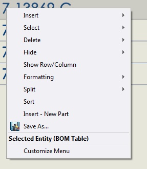

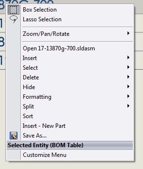

I'm running SW 2017 SP5 and it shows up with RMB:
comment imagecomment image

It appears to show up in the menu after doing a rebuild in the drawing or having the associated files open, but not before hand as in previous version.
