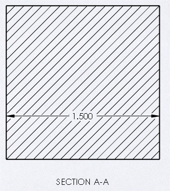

I am not getting a halo around a dimension over a hatch inspite of the fact that is checked in document properties.SolidworksDrawings And Detailing

It appears to work for me in SW2009 SP1.0 See attached.
Can you upload both the model and the drawing (after .zip)? If noteven a screenshot might help.

I just tried it myself on a newly created drawing and gotpositive results..
But it stubbornly won't appear on my specific existing drawing. Nobig deal, I'll chalk it up to anomaly.

That looks better than mine but is it permanent?

The halo is present in all instances but one. This can onlybe a bug.
SF
SF 2009-02-05
The reseller confirmed today that this is a bug. SW isworking on it and hopefully it will be addressed in the nextservice pack.
