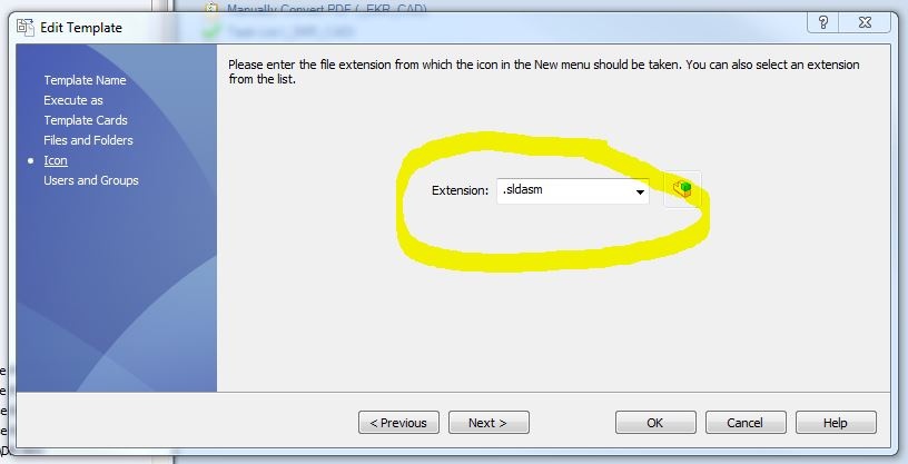

Where do I find the icons used in EPDM?
I am working on templates in EPDM and, as you know, one of the items to define is the icon to be used by a particular file created.   I want to add other icons to this selection list, but do not know the home folder where they live.  I have searched and not been able to find it so far.
Can anyone point me to the folder where these icons are stored?
Thanks again!

SF 2013-10-03 Best Answer
I'm fairly certain that you need to be searching how to assign an icon to a file extention in Microsoft Windows. Based on my experience EPDM only takes what is already in the registry.
Here is one link that may help you: http://msdn.microsoft.com/en-us/library/windows/desktop/hh127427(v=vs.85).aspx
