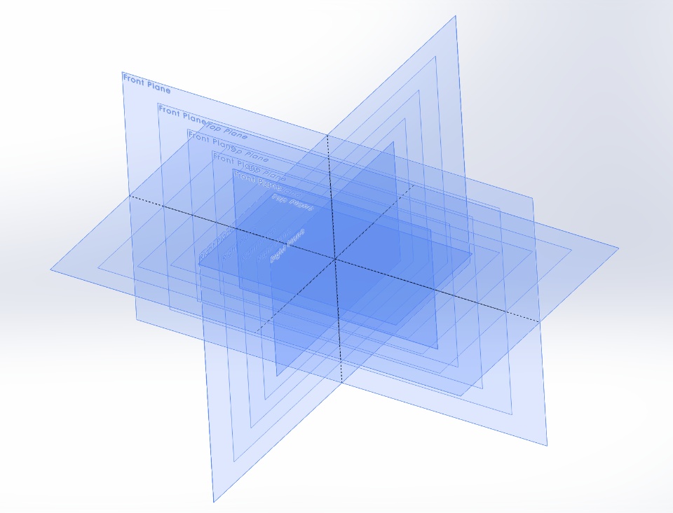

When zooming in or out from a part, picture does not update until rotated.
Recently, Solidworks has changed its behavior for me. Until now, if I zoomed in or out from a part....I would zoom in or out from the part. Now, I zoom in or out and either nothing changes on the screen or I get something similar to the attached picture. If I then rotate the part, the view updates properly and I can see the changes from the zooming that was done.

Sounds like a graphic card issue..
The picture shows only planes, can you hide them?

Please check and update system graphics card drivers.
