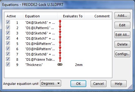

I am making a software in VB.NET that is changing components in an assembly (their configurations and dimensions). I recently discovered an issue with dimensions that are set with equation just stopped updating.
What I later found out is they only stop updating when SolidWorks is started by my software and not if it is already started! And I have tested this quite thoroughly.
