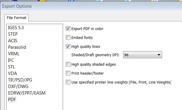

And here is the process. First of all you want to set this so that it stays. If you set this
and the program crashes you will have to do it again. So here goes.
First open up SolidWorks, open up a blank drawing template and go to save as pdf. Go to the
options for pdf's and uncheck 'High quality edges'. Save your blank template to
test.pdf (or some other name you'll recognize; to delete later).
Once this is done close SolidWorks and open it again. This is a pain but if the program crashed
while you unchecked this it would probably revert back to checked when you restarted the program.
Now open the file you want to save as PDF. And run. It looks like this works.
