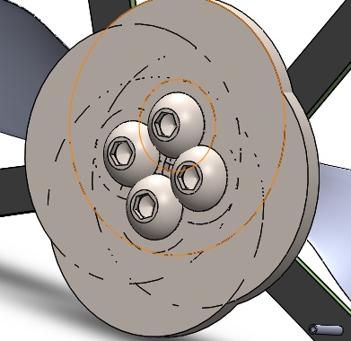

When I open a file from someone the toolbox components open with a different size (they came gi ...
When I open a file from someone the toolbox components open with a different size (they came giant), so I have to correct manually every time than I open someone file. How I correct it?
