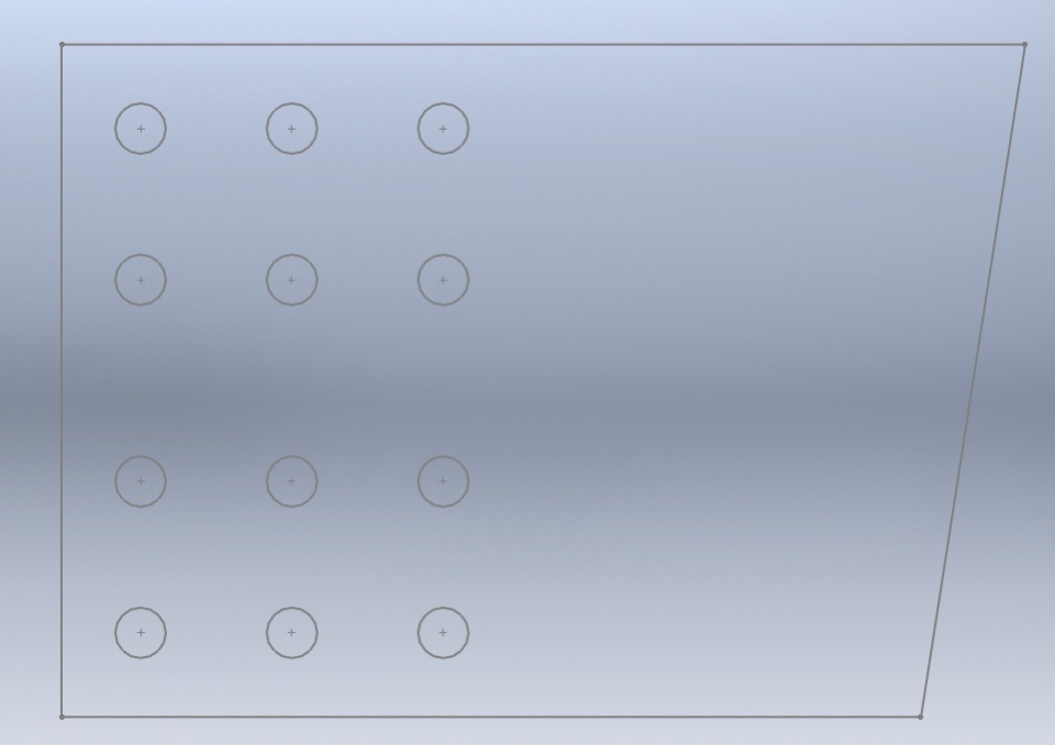

Hi,
I have been sent an outline of a very simple part as a DXF file.
I have imported this into SolidWorks, I have not bothered to fully constrain this part as should be to correct size, with holes in correct position etc
When I go to extrude to its final thickness (60mm) the 30mm dia holes do not show.
It will only extrude the outer shape.
Why would this happen?

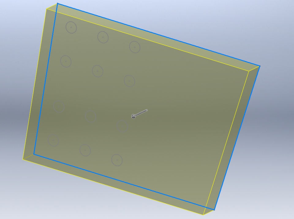

When you extrude, near the bottom of the PropertyManager there is a section for "Selected Contours".  You should be able to go there and get what you want.

Hi Glenn,
I do not see this option.
In the past all I had to do was select any edge or hole and it extruded correctly.
I have have just had an upgrade on my computer in the last week so wonder if some settings have changed.

In your screenshot, click on "Model-Contour<1>" and delete it, then go to the sketch and click in the region you want to extrude.  It should treat the holes as seperate areas and not extrude them.  If not, there may be a problem with the sketch.  If that doesn't work, can you post the part?

Your screenshot is showing "Selected Contours". Clear that box and all will be well.

Hi Glenn,
Thanks for that, all fixed now.
