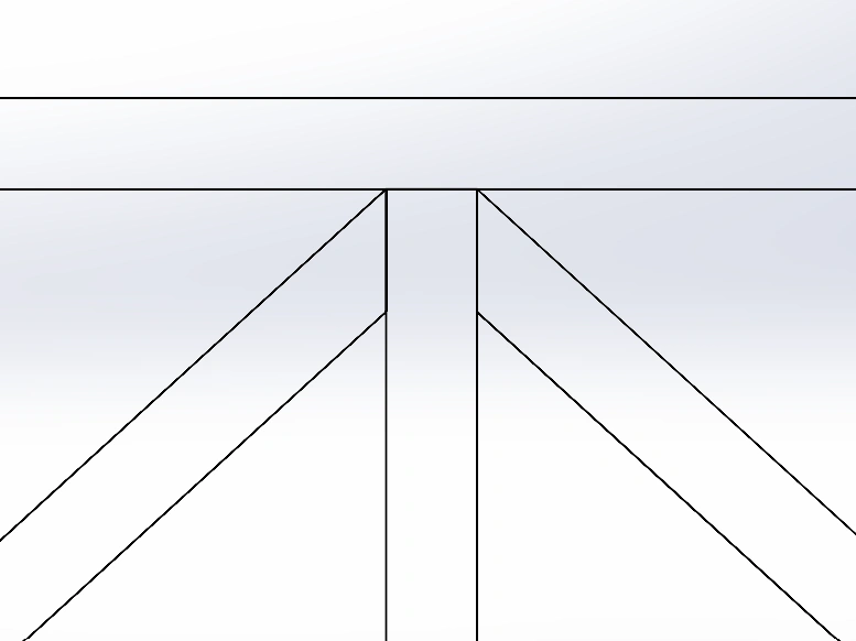

when exporting to dxf in 2025, I do not want to have the hidden lines show up.

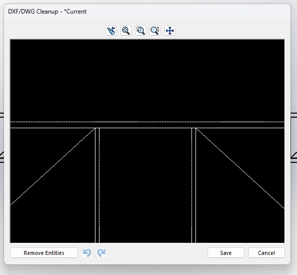

I am trying to export to a dxf and I do not want hidden lines or tangent lines visible.  Working from the part file I have set my view type to be hidden lines removed and tangent lines removed.  Everything appear correct in the display as I would want to show up in the dxf, however when the output screen comes up it is always showing hidden lines and exports with them.

I am going to assume that when you are exporting the DXf you are choosing the "sheet metal option" rather than "faces/loops/edges". If so uncheck the "sketches" option.
If you need the "sketches option" on then also turn on "exclude hidden sketches". This should eliminate any hidden sketches.
JS
JS 2026-02-27
The best way is to create a drawing and export from there because you can set Tangent Edges Removed.
