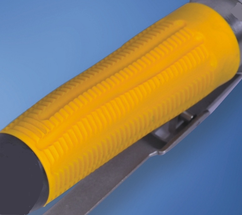

What would be a good method / practice for modeling this Rubber handle grip?
Hi,

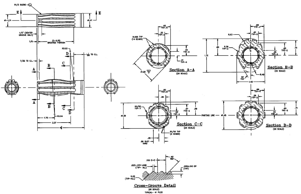

I would like to know the good method for built 3D model for this attached rubber handle.
I am more particular about to making cross grooves on the outer profile,
Can any one guide me?
Attached here the sample images, and drawings for reference.

Nagu, this is how I started my handle. I know the way I am doing it may not be the "best way" but it was working for me. My dimensions may be off some but it was hard for me to read some of your dimensions. I tried to make one continuious sketch but then one of the lines moved and messed the rest of the sketch up. So it was easier for me to just make seperate sketchs, first, second ,third and so on. I hope this helps. Tom

Thank you for your efforts and the model, The method you used, is that i thought initially, but i am looking to optimize this model tree bcoz I don't want to make 41 grooves in the outer surface. I would like to make this some special features like Wrap, Surfaces, boolean operations, mould tool...etc.
I have attached the some more images from the drawing for your dimensional clarity, any way i am not worried about the dimensions, i need only the Grip area i.e, the groove and the slots as shown in the drawing.
Thank you, Nagu. S
