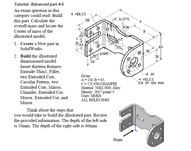

This might be easy for some but if you have to model this part based on the origin from the shaded view define your base sketch and locate the origin as shown.

I have it built, but I ran into one problem maybe its just not a clear pictue but to me it says value B is 65, but if you do that the slot on the left would be cutting into the bend and to the far left edge of the material. Is B value supposed to be 55 to make it down the center of the middle section?
Alos the only other item I did not see quickly working through it was how high above the origin it was supposed to be.

I've interpreted the part as Dustin did but the instructions shows the cutout in the back in the center. That is not what the drawing shows.

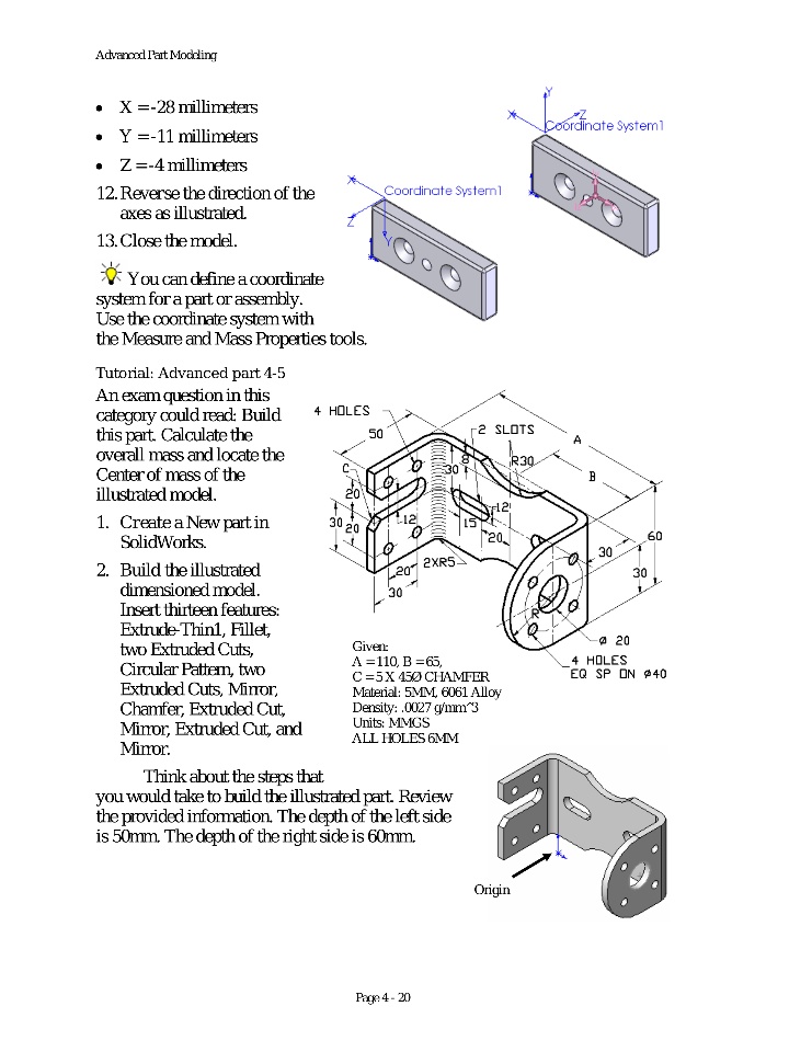

The question in the tutorial is to locate the center of mass to the origin. If you want to get the correct answer then you have to locate the origin per the model in question don't you? Or else your answer will not match the one in question.
By the way the instructions in the tutorial did not model as a sheet metal.

I agree, the drawing is confusing and incomplete.  There are no dimensions locating the right-hand slot in the back face.  While it is easy to assume the circular cutout on the bottom is vertically aligned with the cutout on the top, it is very unwise to make such assumptions.
I think the most important lesson to be learned from this exercise is that trying to completely dimension a part in a 3D view is a bad idea.

To me it looks like they give you the origin location of where they want you to put in your own seperate orgin at the location:
x 1.8mm y -0.27mm z -35.54mm and then give the center of mass in relation to that origin you created.

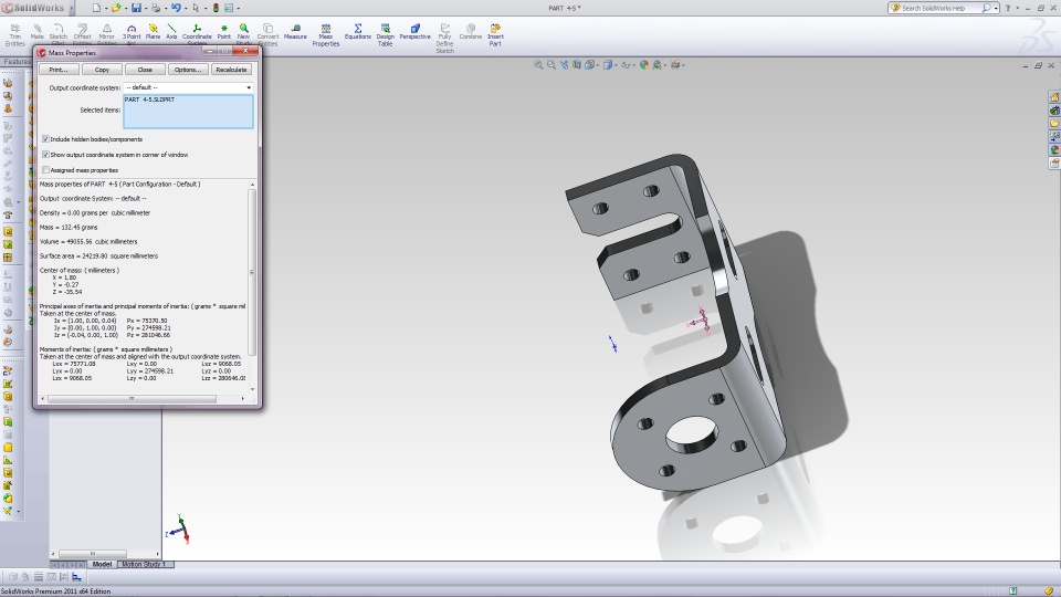

No, they did not give you the location of the origin. After you finish build the part your answer should be Overall Mass = 134.19 Grams and the Center of Mass relative to the part needs to be X=1.80mm, Y = -0.27mm and Z = -35.54mm. If after you build the part to the print and come up with these values then you've answered the question correctly. I was trying to build the part by just looking at the Iso drawing on the first page without following the instructions and the drawing was very confusing so I decided to ask the experts.

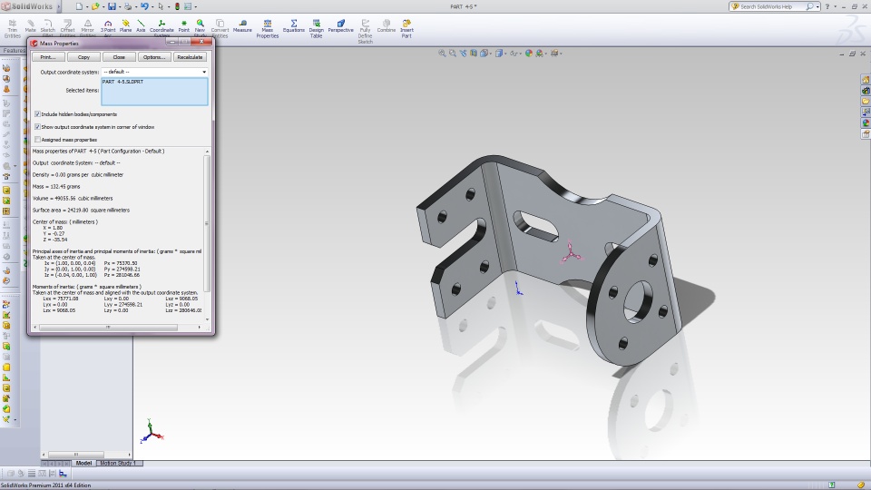

Ok I see what I missed last night, I read through it very quickly before leaving work.  I don't think you can really give them what they are asking for because of the inconclusive drawing that they provided. Or are they wanting you to make your part have a center of mass equal to what they show and then they want you to locate the part using that? So check the data it says X=1.80mm, Y = -1.0 mm and Z = -35.54mm, then move your part up .73mm in order to get the correct center mass location? By doing that it would eventually get you the missing dimensions as to where the origin is located.
SF
SF 2011-02-03

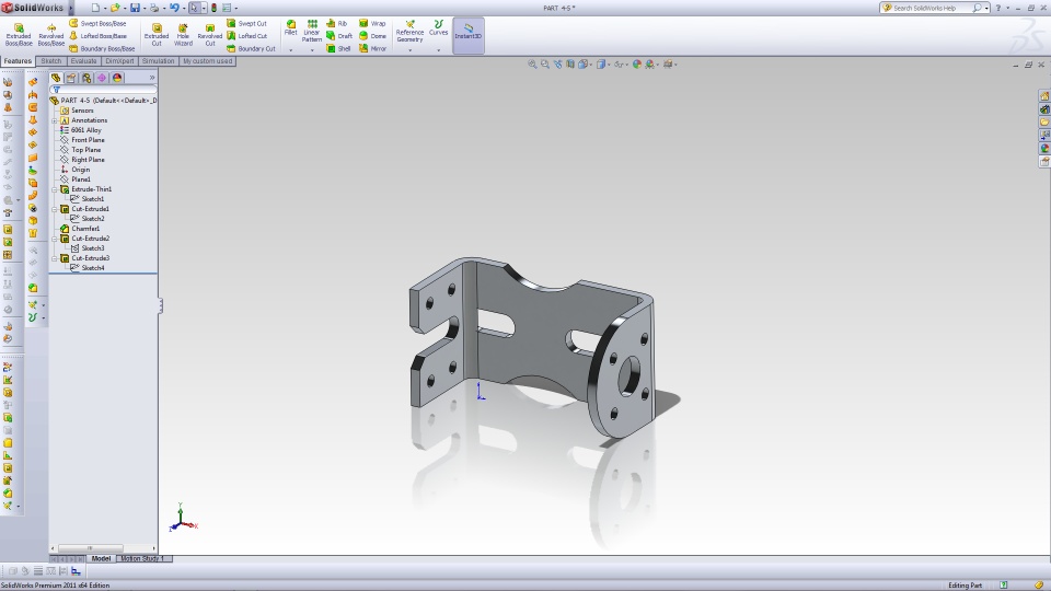

I figured it out, the one image makes the location of the origin look like its in one spot but it is very misleading. I moved my model around to get the correct center of mass and the origin when turned to that view looks like it is below the part but it is not really in that spot. Check the two pictures I have included to see what I mean.
