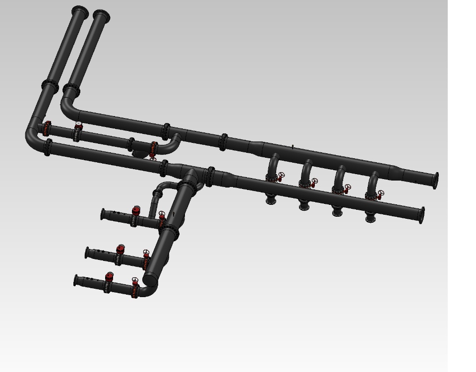

MC
MC 2014-05-07
Mladen,
I have errors that show up where the route feature in the FMT is red but the 3Dsketch inside is not red. The way I solve this is by deleting 1 dimension and then re-add the dimension. This works with any dimension you want I typically use 1 thats a remove pipe then I just remove pipe again. Attached is an example of the size of routes that we typical design.
