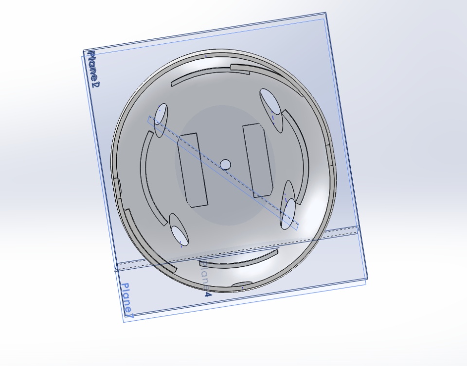

Boss extrude 3 looks fine, but when it's mirrored it's not up against the wall like it's supposed to be. Part of it is off the wall and part of it is embedded into the wall. What's wrong here?

Extrude3 isn't on the interior surface.
Since the helmet continues arcing inward above Extrude3, the coradial is inboard of the surface.
Create a perp plane to Plane8 and the central axis and in section you'll Extrude3 is proud of the inner surface.
Because of that is, I believe, why Mirror6 goes goof.

Hello,
When I opened the part, view temp axes was on.
By "central axis", I meant the temp axis at the center of the helmet:
Click ok to create the above plane, then use it to do a section view and you'll see the extrude is in the inner surface:
I hope this helps,
Kevin C.

I don't know why that mirror isn't working. It appears to be a glitch or bug.
Workaround: Create an axis at the intersection of the front & right planes, and use a circular pattern.

, Whether Boss-Extrude3 is merged or not with the helmet shouldn't make a difference, because the Mirror6 feature used the Bodies option.
The location of the mirrored body is just wrong.

your part appears to be symmetrical. why not just cut the part in half and mirror/pattern the whole body that is modeled correctly. much easier approach with less room for error.

It isn't a glitch or a bug.  Every vertex on the mirrored body is correctly mirrored across the mirror plane.  The mirror plane definition is incorrect.  The mirror plane is defined as the midplane between the Front and Right planes, but the feature being mirrored isn't located symmetrically between the front and right planes.  This view shows what's happening.
