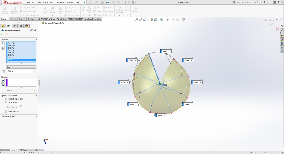

I got the surface to work until this point. I keep having problems when I try to do the last section.
Hi.
Select first your bottom sketch as Direction 1 and profile sketches as Direction 2. No problem here.
Hi Eric,
You're trying to go all the way around? I don't think you can use the same sketch twice.
I'm assuming the helmet is symetrical? model half as far as possible.
is this what you want as I don't have any problem with it
I didn't select the bottom sketch as direction 1
Eric,.. you need to check "Close surface"... but if you use Sketch2 for Direction 2.. then it will automatically close.
