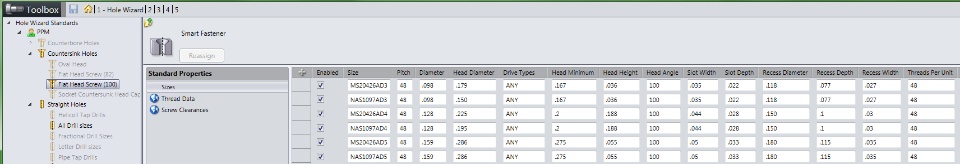

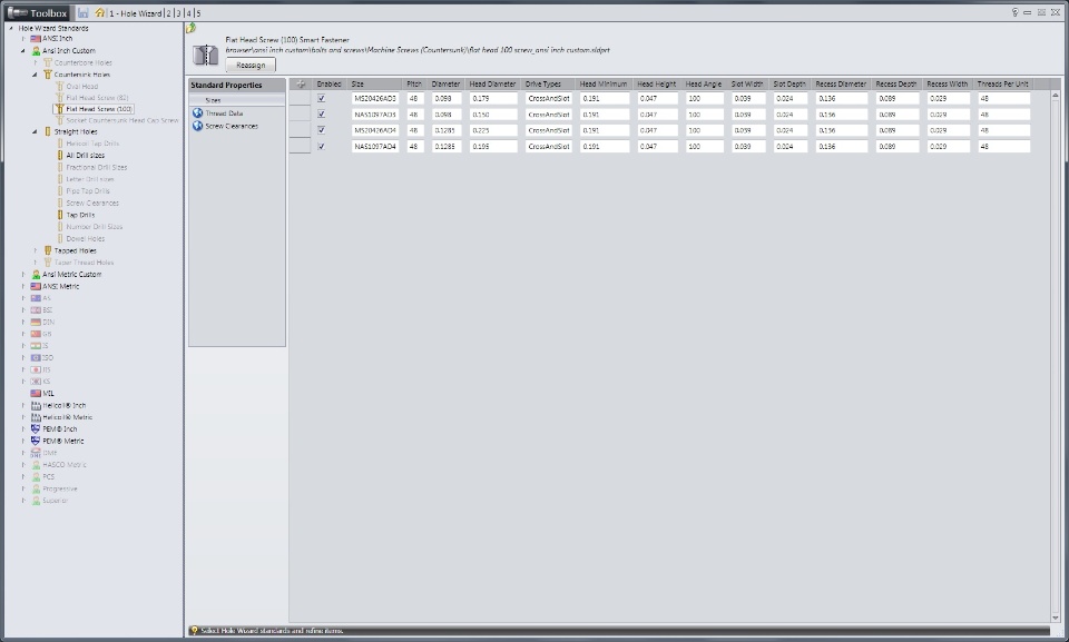

  • Created my custom countersink sizes in the Flat Head Screw (100) submenu as shown below.  I fudged some numbers I am not concerned over, using reasonable values just to fill in everything (as is required).

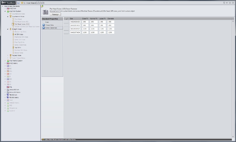

  • Entered screw clearances to satisfy that requirement, I'm not concerned with how the holes fit so I used a single value across all.

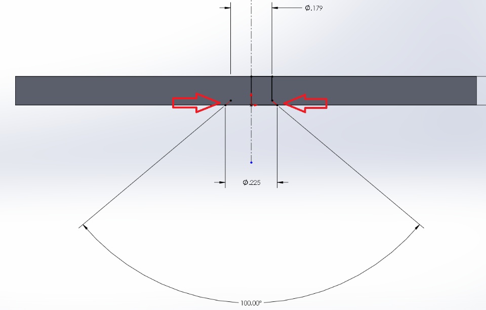

  • This gives me a preview that looks okay in preview but doesn't give me the correct feature.  I explore the error in the sketch and I see this:
    and when I move the Ø.225 dimension leader it changes to Ø.179
I complete the feature and the MS20426AD3 is dimensioned like the ...AD4 size, & if I switch it to the ...AD4, it keeps the same dimensions but the countersink acts as the TRHU hole.

Check that the free floating angled line is a construction line.  The other things you can do is use the "Display/Delete Relations" tool to see what relations are used, broken, external (I use this allot when I have warnings on sketches). If neither of those has solved your issue use the Sketch Tool -> Check Sketch for Feature, for a revolved cut.  That should allow you to troubleshoot your way out of this.

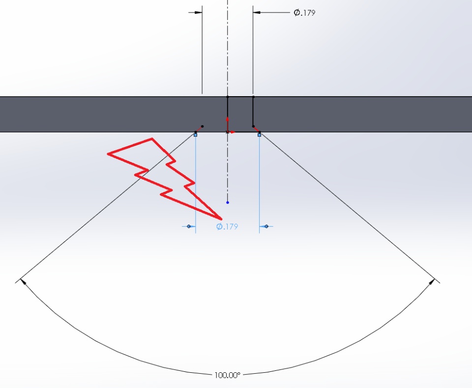

I think the "Diameter" value that you enter in the table should be the countersink diameter. The way you entered it the csink diameter is the same as the thru hole diameter and that is why the sketch is messing up. Change the diameter to something larger than the clearance hole and it should work. If you just want a straight clearance hole with no countersink then you should be using straight hole, not countersink hole.

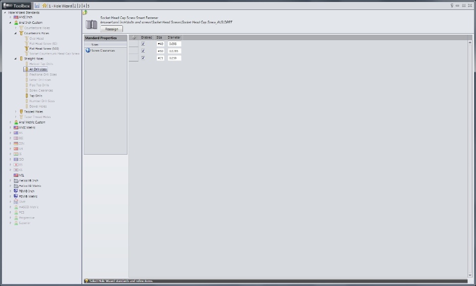

Thanks for the input everyone, still troubleshooting here..  I'm expecting you have all figured out what my goal is but just so I state it clearly here it is.  The sketch I'm displaying is the hole wizard auto generated revolve.   I want it to produce a Ø.098 hole with Ø.179 c'sink and I'd like to name this feature MS20426AD3 if possible.  Once that works I will follow the right combination for the other 5 holes I want to develop.
Arthur - I inspected the sketch elements, and when I started deleting the conflicting relations it did not lead to the feature I'm going for.  Not only is there a conflict in the sketch that it is generating for me, it's giving me the dimensions for the wrong size hole.  There's got to be something I'm missing or entering incorrectly in the toolbox.  The Ø.179 c'sink Ø.225 hole it is generating is a combination of two c'sink Ø's from two separate rows.  Normally I could troubleshoot this type of error with your proposed method but I'm still scratching my head about it.
John, can you be more specific?  Where do I enter a screw size that I haven't already covered?  I entered data under the Standard Properties -> Sizes & Screw Clearances, skipping over Thread Data, I don't see anything I need to enter there but what do I know..
Jamil, I have tried to manipulate the entries in a couple ways to explore the possibilities, all combinations that I thought to use gave me errors.  Based on the existing entries for similar sized holes I left it at what you see above.  I may need to recreate my custom Standard & start again slowly unless someone could try to recreate my entry and provide some insight into which entry is directly causing my trouble.  There is a large processing lag for me to create my custom standard.  There are multiple entries named & related to "Diameter".

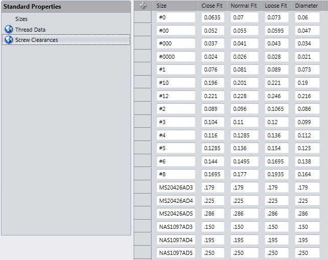

Hi Mike, I was wrong in my first post but after looking at the standard ANSI csink I think I've figured it out. Your setup in the "Sizes" area is good. In the "Screw Clearances" section the values you enter there should be the values for the screw clearance hole, not the head diameter. You can enter different values for close, normal and loose fit, or leave them all the same. The Diameter field just seems to be the nominal screw diameter, I don't know if that value actually does anything.
In your screenshots I see you put the head diameter in this area. If you change it to the screw clearance diameter it should work.
KB
KB 2015-08-10
here's how I set mine.
you didn't post your drill size page so ...
since .128 doesn't exist by default (default = .1285) you will need to add a drill size for it.

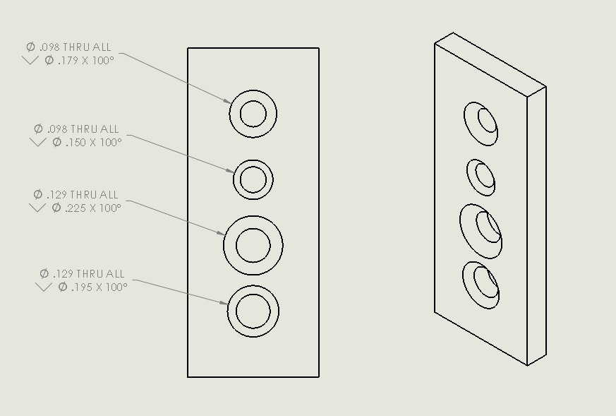

Yes, here's my requirements
A=.098
B=.179
C=.034 (defined by 100 c'sink) - .034 reference
JS
JS 2015-08-11
Set all these values to .098 and see if that works.
comment imagecomment image

I found it.  You good people led me to get my tables straight and that was part of the issue.  The other part was my previous approach to the Hole Wizard, I'll explain.
I was previously creating my countersink holes by altering the Hole Specifications > Custom Sizing
Some how even with creating new Hole Wizard entries, it was bringing in memory from my previous custom hole entry.  Uncheck the box and the values aren't displayed.  Check the box and modified dimensions appear in a yellow field instead of white.  The THRU hole diameter was yellow and incorrect for the hole sizes I had newly created.  This was overriding my table entries even with the custom sizing box unchecked.  I don't understand how that's possible (this feels particularly buggy), but when I checked the box, entered .098 to match my table the yellow field went white and my hole works.
I'm giving some thumbs up to everyone's helpful contributions, and I'll give the win to Kenneth for showing the complete tables & for pointing out the straight hole drill size which I was bound to get stuck on.  Thanks everyone.
