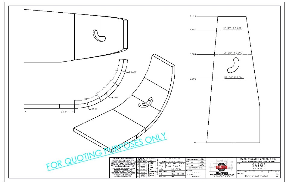

I'm new in SM-land, but after attending Gerald & Wayne'ssessions at SWWorld, I'm not as intimidated.
I'd like to add something (lines, surface edges, etc.) in the bentstate that will translate into the flat for the purpose of locating(dims on dwgs) items during assembly.
As you can see from the attached pic, the line locations are notalways equally spaced around the curve. This is for plate work, butI'm sure someone has tried this in SM.
I've tried creating surface breaks with planes, but encountererrors going flat. I've also tried split lines, with no success.
This is part of a large duct, and stiffeners will be added. Itwould be great to mark the stiffener locations when designing 'asbent' then have accurate placement markings in the flat.

Use theUnfold tool, place the marks (tiny dimple or hole), thenFold.
I'm sure small physical features would work, but I'd like a methodthat doesn't change the surface. If I eventually take the models tomfg with the additional features, I'll just have toremove/sort/layer them at some point, correct?

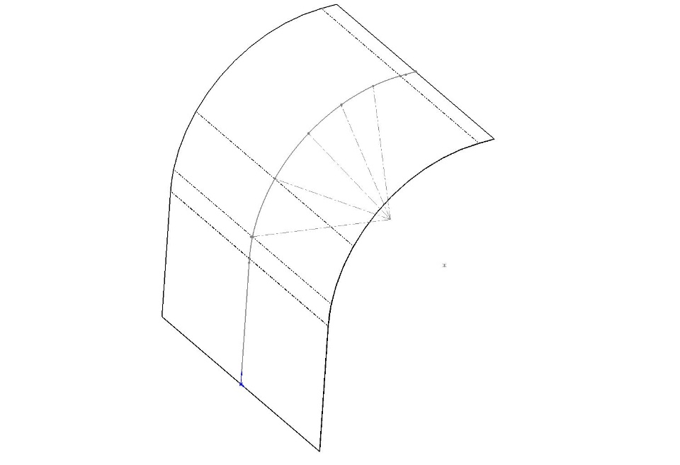

I think I was able to acheive what you are after by sketching theprofile as a series of tangent arcs. You can have as many or few asyou need and dimension the arcs either linearly or by their angle.The glitch is, adjacent radii can not be equal, it only takes aminute difference to make this work. Once the sketch is completeuse the Base Flange feature to convert to sheet metal. I was evenable to use the Unfold/Fold feature to place features in the FlatPattern state.
Not exactly sure this is what you are after, but it was a funlittle exercise!
