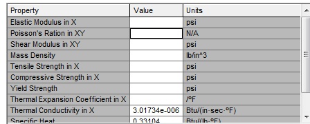

I'm creating custom material for FEA linera static model. I know only the yield strength and tensile strenght of the material. Is this enough for FEA or I must define all other properties exactly as per material? What material properties are will have impact in FEA?

For a linear static analysis, I think you will need to define two of Elastic Modulus, Poisson's Ratio and Shear Modulus.
