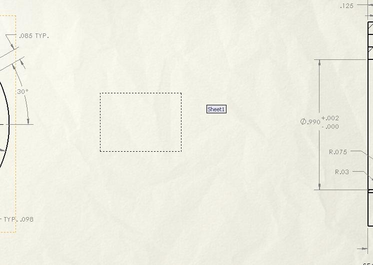

Hmm it eventually disappeared. It had just appeared while Iwas working on the drawing, and wouldn't go away.
SF
SF2009-06-10
Jay Andrews wrote:
Hmm it eventually disappeared. It had just appeared while I wasworking on the drawing, and wouldn't go away.
That could be a graphics card issue. However, did you look inyour featuremanager to see if there were any "extra" viewspresent?
SF
SF2009-06-10
We had one like that show up back with version 2007, no extraviews, just residue of some sort. Good place to set yourcoffee.
JA
JA2009-06-10
Yeah, a quick check of the tree at the time I didn't seeanything. I figured it was just a bug, but it wasn't going awayimmediately so i figured I'd ask if it was some feature i wasn'taware of that might be good for something...my mistake
SF
SF2009-06-10
Black hole?

This looks like a view is attached to your template.
Open your template and make sure that there are no pre-defined views in it.
I have noticed that this will sometimes happen if I have a pre-defined LEFT view (for example) in my template, but the part that I am adding to the drawing (when I use that template) doesn't have a defined LEFT annotation view.
remains of a deleted view?
