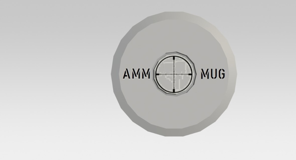

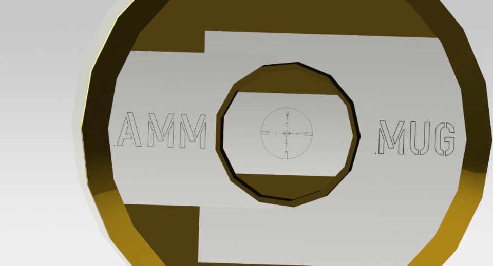

I need to be able to creat custom logos, etc which I then apply to the surfaces of my Solidworks models. What software do you recommend that works well? I have tried Corel Paintshop, MS Paint, Powerpoint and even Word. The lines all look crisp and correct. The text looks great. Then  I import into Photoworks and applay as a decal to the model's surface. Even when I use the 'selective color mask' tool, I still get a lot of white and light gray pixels in the background of my decal. See examples below. Can anyone please recommend what software I should be working with that can talk to SW/Photoworks? Thanks!
In these examples below, I am showing the Part to which the decal is applied both with and without the Brass appearance applied.

Corel should work fine.  Don't use the "selective color mask option".  If your using PhotoWorks create your own mask and use the "mask from file" option.  If your using PhotoView 360 2011 create your image on a transparent background in Corel and save the image as a PNG.  Then check the "use alpha transparencey" option.

Nope, you'll need some sort of image editing program to make the images for the decals.  Paint.net and GIMP are free ones.  Corel and PhotoShop of course.  Also the new Paint in Win 7 is more capable.  If you have Corel I would use that.
In Corel when you create a new image there is typically an settings dialog for the image and you have background options in there.  One of them is transparent background.
