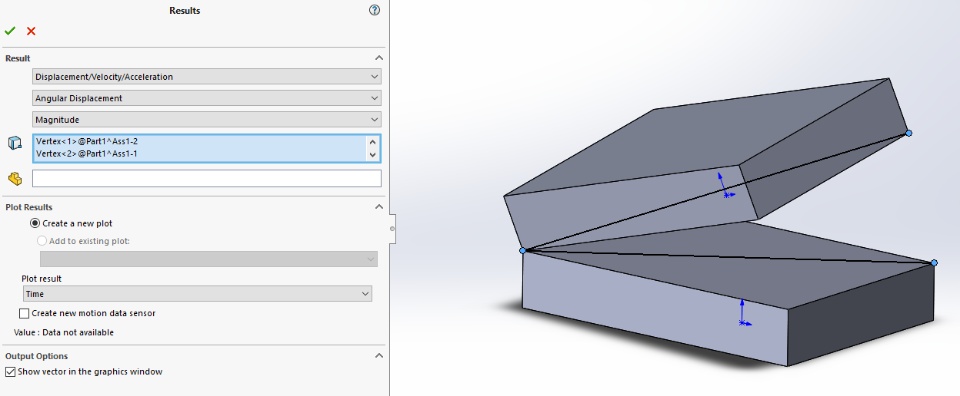

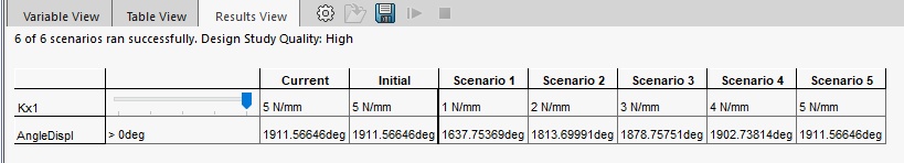

I can't understand how the design study receives such an angle? Instead of 30 degrees it shows 1900 degrees! How?!

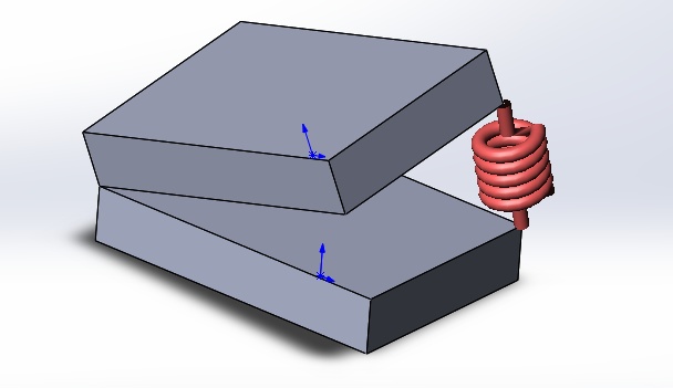

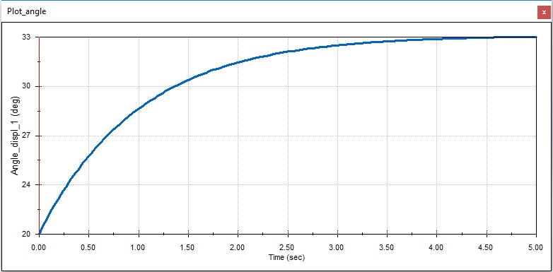

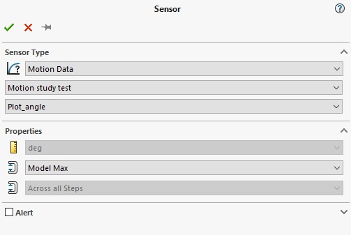

Model: two plates are connected at one point hinged on diagonally opposite points of the coupling spring. Normal calculation in the Motion Study shows maximum displacements of about 33 degrees. When trying to solve optimization problem with a single variable in the spring rate, the result of solving an optimization problem to get the values of the angle of inclination of about 2000 degrees.

Alexey, this problem is known and has been reported as SPR 614207.
To request a fix and be notified of the evolution of the status of this SPR, please search for SPR 614207 in the SOLIDWORKS Knowledge Base (KB) and select 'notify me'.
At the current time, you can multiply the values you see in the table of results by PI/180 to get the correct value in degrees.
