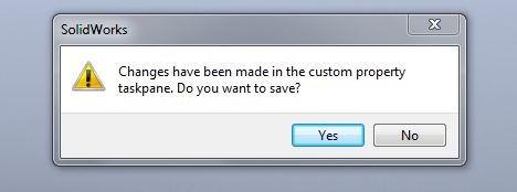

Now custom properties tab as some apply/reset tab. also when you change them, or go to Save the file, it asks
"custom properties has been changed would you like to save"
like as if you want to save a copy of the file with the old old custom properties before you make the changes.

even when you change the properties and go to file, save as, it still asks you if you want to save, which of course is what you are already doing by clicking Save as.

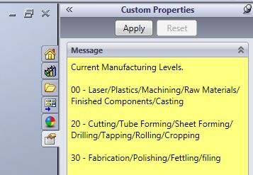

ill take a screeny of the offending things. Really un-nessesery and confusing. now you get user doubts like, do i need to press apply for them to work? do i need to save it? when i save it am i saving the original or as a copy?
so far i have not found a option to remove, nothing changed in the property tab builder.
now what would have been usefull is a option to have the "message" on tab builder as a "Expanded" or "collapsed" option
pics attached.
First is the Apply bit.
Second is what comes up when you change a property then go to Save as.
If you click yes or no - it still goes to the Save as box, so are you saving the file with the old custom properties? or are you saving them with the new? or are you saving a copy or something?  probably the most annoying thing i have seen in a while.

Here are a couple of screen shots.  If I select no not to apply what has been done up to
this point, after selecting the material, I lose what was filled in previously.
comment imagecomment imagecomment imagecomment image
SF
SF 2011-06-13
Quite interesting!  I had not seen that message before, and when I tried to see it, I could not at first.  I finally figured out that if you make changes in the dialog and then click out in the graphics area to say "I'm done" without hitting the apply button, you don't see anything.  But then do a rebuild and that message appears asking if you want to save the changes you made.  If  you say no at that point, then changes are dropped.  Yes obviously applies the changes.

I saw that.  I think what's happening is that the material change dialog that you have inside is forcing the focus to leave the PM and shift to another dialog.  This then forces the prompt to save the changes you have made in the original dialog.  All the stuff I have in ours is "internal" so I hadn't seen the issue before.  By putting the "other" dialog first, there are no changes yet in the main one so a change in focus does not trigger a save.
