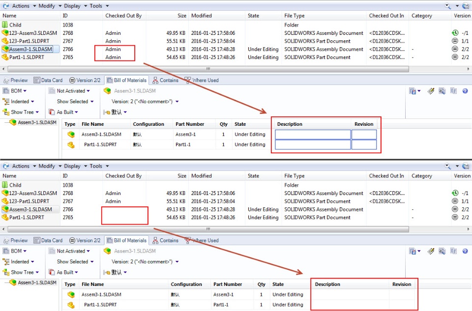

What are the blue boxes in the Explorer BOM?
I called Support yesterday and they were unable to tell me. The only thing I can tell is that these boxes allows me to edit the field. Those fields technically should not be editable, which is something else I don't understand.

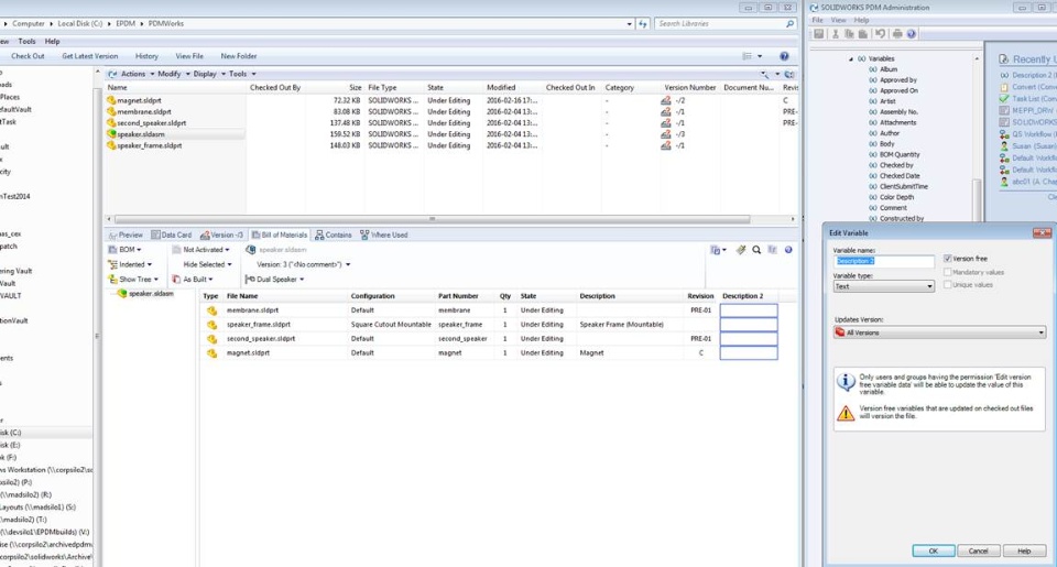

Scott, seems it is related to them being editable- here is the Knowledge Base solution and images that it references:
comment imagecomment image

AWESEOME! - Thanks Adam! That was what I was looking for.
