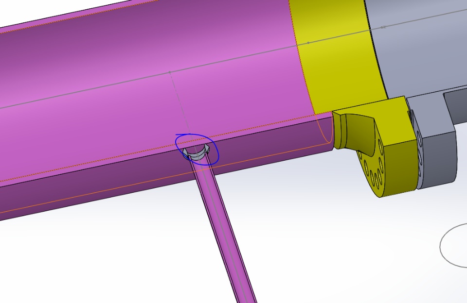

Hello,

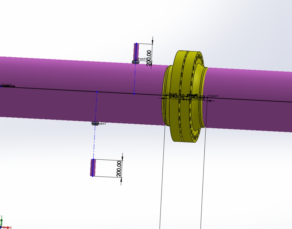

I'm having a problem with weldolet not attaching the pipe properly when in downward position ( -Y axis).
The weldoled works fine in other 3 positions, upward and sideways. Just not in downward position, and i don't have a clue why. As you can see in the first picture, when i give dimension for pipe lenght that problem occurs.
The part is from SW database but edited so it can fit to a 28" pipe, 28" x 2".

Dusko,
The first issue you mention is a bug. I've had similiar things happen even without weldolets.
Concerning the second issue with flow simulation : you'll have to ask your VAR about that but I would think that without work-arounds the answer will be "no, you can't" because, as you'll have noticed, putting a weldolet down in Routing doesn't even create a hole in the the main pipe wall.
