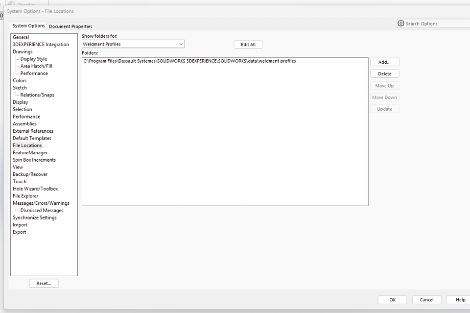

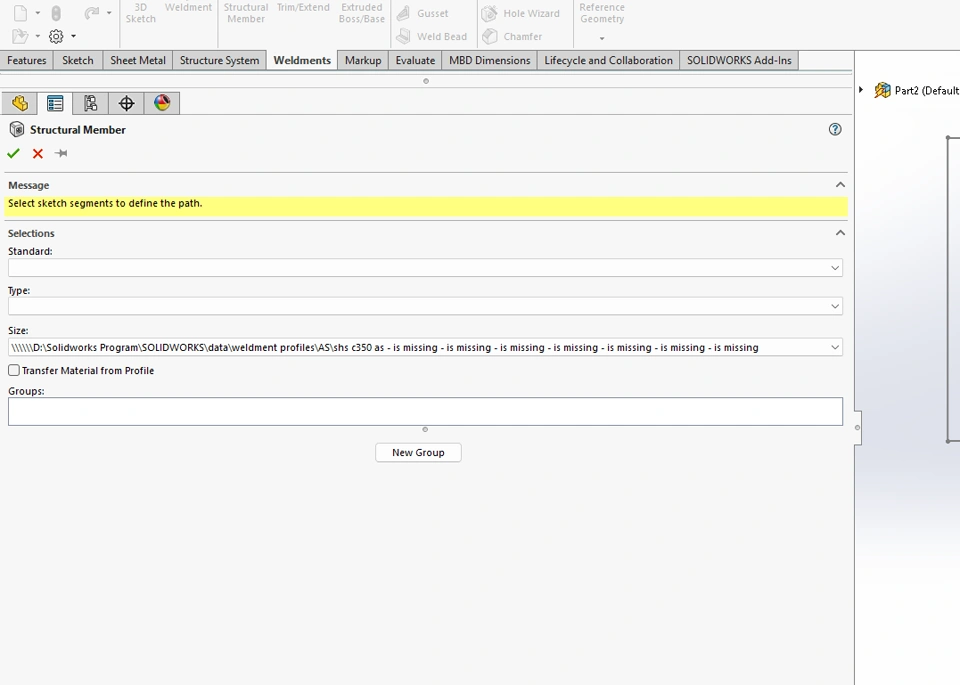

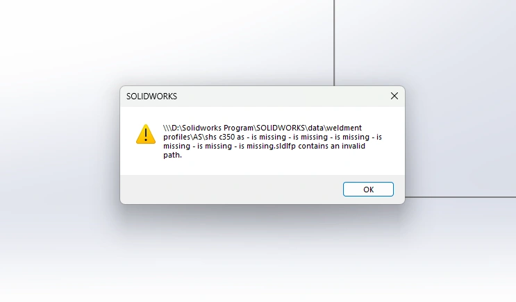

I'm using solidworks maker and since the last update i cannot use weldments anymore. I have uninstalled and installed the program. Tried every tip on the inter net. Checked that all the path are correct. I have downloaded a few zip folder (As,Din,Iso) through the design library. It always comes up with the same issue. It looks like it uses one of my old projects as a default. I cannot find a folder for wledments in my Solidowks folder on my pc.
Attached a few screenshots. Appreciate if someone know a solution.

Try creating a folder along that path shown in your screenshot and place your weldment profiles there.
