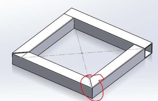

I'm using SW2018 Sp4.0 and could not put 3mm weld gap so my only option is to put cut extrude which I do not like, Attached here is my sample weldment can anyone please diagnose it.

If all members are the same you can apply all this at the structural member feature
Edit structural member feature and select the points in the corners

Yay ive always been using the point selection to trim 3 members but I never thought that it will works for two members. another tips I learned again thanks
