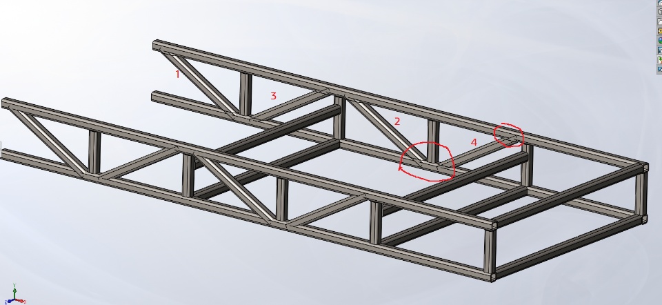

I have a frame I am making as a weldment and have found a few things that I have questions about. In the view below I created one 3D sketch to drive the whole model. Then when creating the cross bars I could create tubes 3 and 4 in one group but could not select both 1 and 2 in the same group but needed to create them separate. What would be the reason for that?  When creating the horizontal and vertical parts they came in square to the frame but I had to rotate the angled parts, easy enough to do but it takes extra time, is there something i need to edit to have them come in as desired from the start? Then when trimming the tubes I was able to get the vertical and horizontal parts to show correctly but while the angled parts show the trim location, they still also show extending into the part and I can not get that to show correctly. Am I missing a step?

Jim,
Here is a screenshot of your model I re-worked.
I attached the file as well for this model. It is in 2017 so hopefully you can open it. The twist in your angled pieces comes from the angle at which they are being extruded. The planes dictate which way the twist of them will go.  .
You can make this with one weldment feature, it cleans it up and makes it easy to manipulate in the future.
Any time you have 2 different weld features intersect you do have to use the trim command.

<p>Jim Steinmeyer wrote:</p><p></p><p>I have a frame I am making as a weldment and have found a few things that I have questions about. In the view below I created one 3D sketch to drive the whole model. Then when creating the cross bars I could create tubes 3 and 4 in one group but could not select both 1 and 2 in the same group but needed to create them separate. What would be the reason for that? <span style="color: #2873ee;">I have no idea.  </span>When creating the horizontal and vertical parts they came in square to the frame but I had to rotate the angled parts, easy enough to do but it takes extra time, is there something i need to edit to have them come in as desired from the start? <span style="color: #2873ee;">I suspect it's because it's a 3d sketch.  If these sketch lines had been created on a Plane in a 2d sketch then they should have come in square (assuming the profile sketch is square in the .sldlfp file, and I'm sure it is).  </span>Then when trimming the tubes I was able to get the vertical and horizontal parts to show correctly but while the angled parts show the trim location, they still also show extending into the part and I can not get that to show correctly. Am I missing a step?  <span style="color: #2873ee;">See the screenshot below.  When I edited the feature it showed "Keep" on all those little boxes.  I clicked on the to one and that changed it to "Discard".  Do that wherever needed.</span></p><p></p>
Hello Jim,
Please see my replies above.
And for what it's worth, I'd have probably created everything on one side first, with a 2d sketch on a single plane, mirrored it to get the other side, then connected them with the cross pieces.
Also, if you don't mind, I'd have only created at most one extra plane (besides the basic Top, Right, and Front).  I'd have created it first, half the distance off the Right plane as my total width and created my sketch on it to create the bodies shown above.  Then after that side was finished I'd mirror the bodies over the right Plane.  Then use the surfaces of those pieces for the planes to create the connecting pieces.

Your question about having to create weld members for each of the angles is that there are different angles for each one of the members going roughly in the same direction. The angles have to be exactly the same for the weld tool to create the profile. When working a 3d sketch with weldments you usually have to twist the profile back to horizontal as it aligns as it goes.
Like ​ said I would have made one side then mirrored it and then put in my cross members as a final weldment, but since you already had a 3d sketch I just whipped through a quick weldment of it as is.

Thanks a bunch guys. I will take all of the suggestions I can get. I have a lot to learn about weldments and how to lay them out. I was unaware that I needed to select the parts to discard, I saw the boxes but didn't realize I needed to do anything with them. This project is cleanup from a former engineer who's model blew up so I thought it would be a good place to use a weldment and practice. Yes modeling one side and mirroring would be quicker but so far  have not been a big fan of mirroring anything like assemblies but this would be an area where it would probably work well.

One very important thing to remember when mirroring in a weldment part is to be sure you de-select the default "Features to Mirror" and select "Bodies to Mirror" instead (and the same is true for patterning).  I'm sure you already know that, but someone else reading this might not, and I've seen many people here who got bit in the posterior by that little detail.

I use weldments a lot and always try and use 2d sketches and mirror if there are symmetries. This also saves having oddball weldment members come up in cut-list which can be a challenge to sort out.
3d sketches work generally OK but have alignment issues as has been noted.
