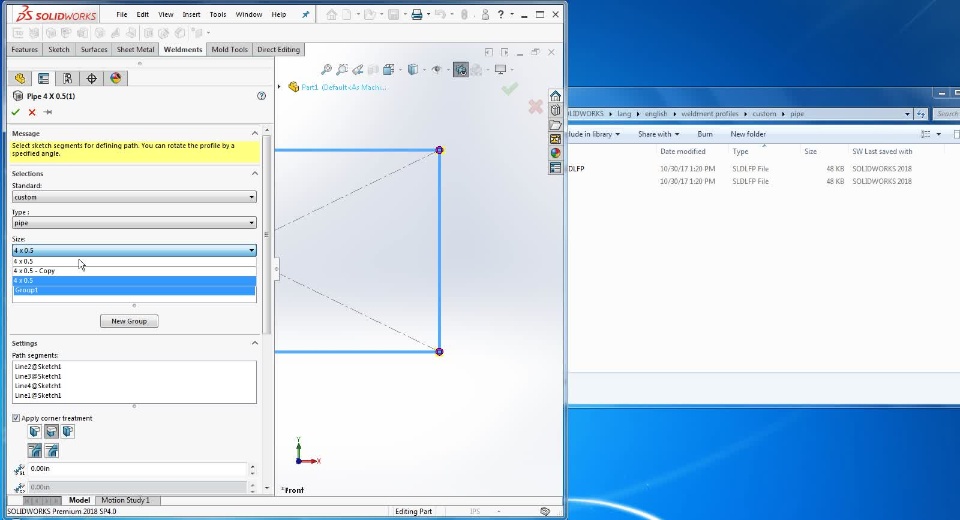

<p>Stephen Brett wrote:</p><p></p><p>I just found another solution to the problem.</p><p>The Solidworks content standards downloads have the file path name in capital letters. The File path has to be in lower case.</p>
Sorry but I do not agree to that. Even with the upper case, the profiles works as expected and they should. Check attached video.
comment imagecomment image

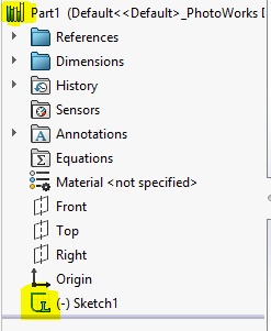

Hello K.B,
Sometimes it may happens because of weldment profile sketch is empty. Refer attachment 1 & 2. It should be like attachment 2. If not, RMB on the profile sketch and select add to library.
