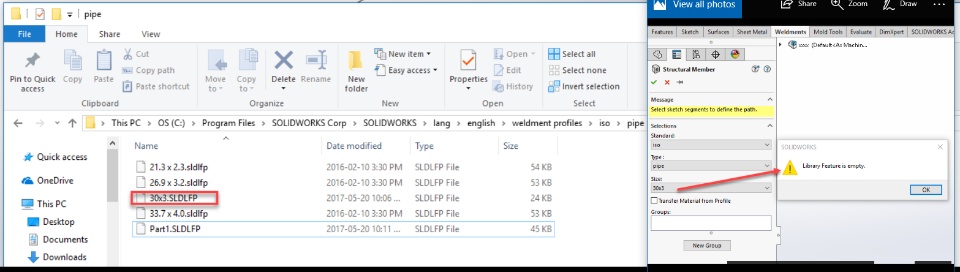

This was a Custom Made Weldments Profile. When I tried to place Structural Member, this warning message pop-up. What was the reason for that?

Make sure you're creating and saving the profile correctly: How to create Weldment Profile

Second time I started from scratch, now it is okay. I do not know how it happened.

<p>Maha Nadarasa wrote:</p><p></p><p style="background: white; margin-bottom: 0pt;"><span style="font-family: 'Verdana',sans-serif; font-size: 13pt;">Thanks</span></p><p style="padding: 0px; min-height: 8pt;"></p><p style="background: white; margin-bottom: 0pt;"><span style="font-family: 'Verdana',sans-serif; font-size: 13pt;">Second time I started from scratch, now it is okay. I do not know how it happened. </span></p>
You may have neglected to have the sketch selected when saving the file as a library part.  That's a common mistake.
