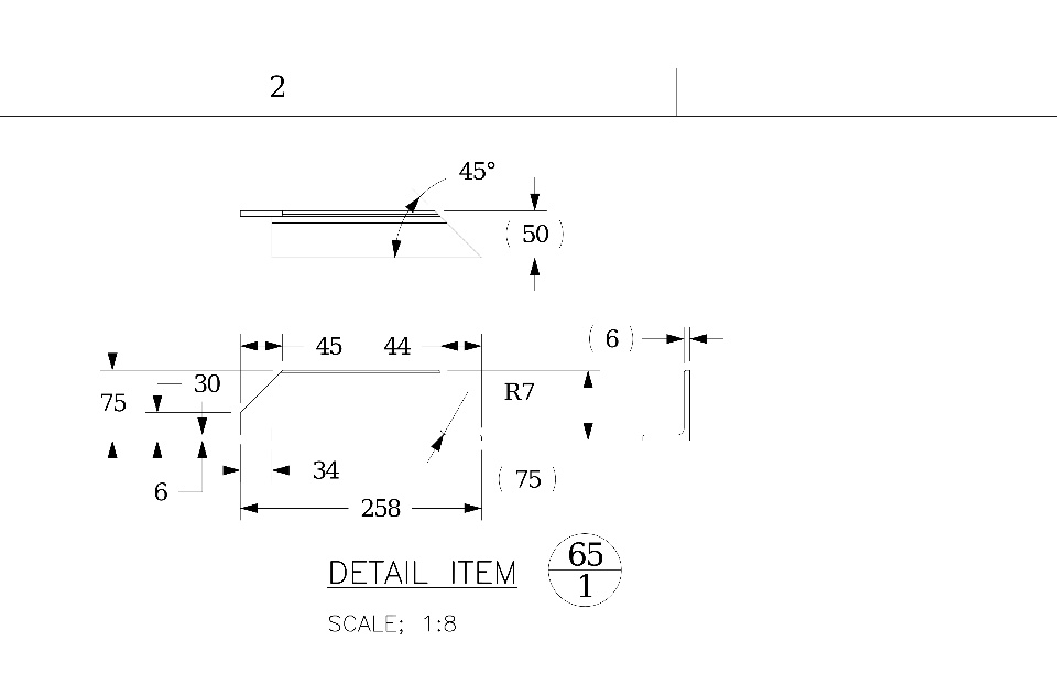

I am looking for a way to link some text in a weldment to the cut list item number?  For example, when detailing a particular part from a weldment I have created a note favorite that when linked to a particular detail will populate the scale of the detail automatically.  However, I would like it to link to the cut list item number as well.  Right now I make a balloon with the item number and link that to the description.  That works as long ans nothing ever changes the cut list item number.  However, often we use an existing weldment, save as a copy, and modify it in some way for another part.  Often this may include different materials, more or less parts, etc.  In that case the cut list item number for a particular part in the multibody weldment may change. Some of these that we use may have in excess of 75 different parts in a single weldment.  You can imagine the potential for mistakes and the time it consumes to re-check the details all the time?  To add to the potential for mistakes, we may have the same weldment being worked on in Texas, Canada, Singapore and the UK through PDM.  I would like to create a template for a note someway that all of us will use so that the consistency will be there and to try to save some time and screw ups on these,
I have attached a screen shot of one part in a weldmnent.  In the note, as I described above, the scale detail is easily linked to particular view.  The balloon that you see is how I like it to look.  However, I have only been able to get the item detail and qty in the note by place a balloon first to the part and then "clicking" the balloon inside the note window.  This is OK as long as the item number and/or qty never changes.  I have looked through every property that I can find for linking a note or annotation and cannot find anywhere to link the item number and qty.

Can you add that property to the weldment profile so that it is carry over to the cut list always. And in the drawing you can link to that property of the cut list.

I have tried that.  I thought that there may be a way in the cut list properties (where materail, lenght, description, etc) is located that I could create a line for item number and quantity then find that property to link to a note.  Probably, this can be done.  However, I have not been able to figure out how.

Quantity will based on no of similar profiles (i.e replica) and then item number will be based on the position in the cut list. So not sure how you can control that.But if you add any property in the weldment profile (i.e. the sketch which we choose while creating weldment), will be carried to cut list automatically.

I agree, I can link just about any dimension or property from the sketch but I cannot link the qty or cut list item number.  It may not be possible but I thought it was worth a try.  The property is located somewhere because it shows up in the cut list table.  I just cannot find where this property resides so that I can link it to a note.

The problem that you are goimg to run into with weldment parts in this case is that you are probably using a relative view.  A relative view works a little different because SW's is actually generating the entire weldment and then subtracting the parts you don't want.  The item number for that view can not be linked to the view because the view could contain 1 to all (75 or more in your case) of the weldment bodies.
The only way I know that works is to have the note tied to a balloon from a view.  Then if that item changes numbers or qty's the note will update with the balloon.

Sorry I re-read your original post and realized I missunderstood at first.  If you want to tie the note to a cutlist item then create a view balloon the item and then click this balloon into your note.  If that item ever changes number or qty your note should change with it.  This should work as long as the view or the balloon in the view doesn't get deleted.
