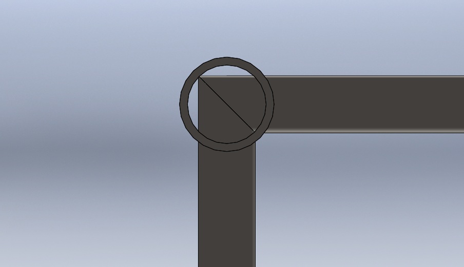

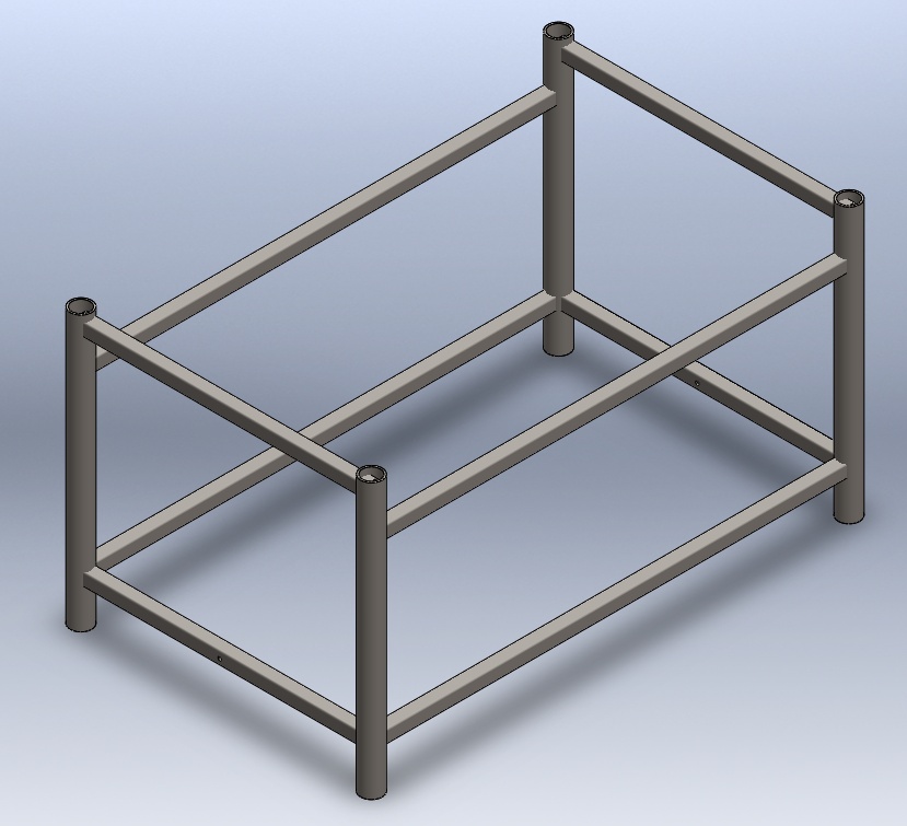

I am working on a tube frame weldment that utilizes round pipe and square tube, please see the image below
The issue I'm encountering is that the square tube is not trimming to the round pipe, as you can see here:

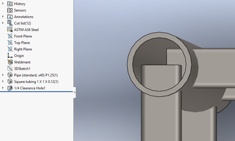

Here is my feature tree for reference, as well as another view of the square tube clipping through the pipe without trimming:
Any ideas? I'd really like the square tube to trim to the "edge" of the pipe, a flat trim would be fine, a rounded trim would be a bonus.

<p>Karl Nielsen wrote:</p><p></p><p>I'd really like the square tube to trim to the "edge" of the pipe, a flat trim would be fine, a rounded trim would be a bonus.</p><p></p>
Welcome to the forum.  You're really going to love the Trim/Extend feature.
comment imagecomment image
SF
SF 2016-03-03
That is exactly what I needed!
I thought maybe there was something I was doing wrong in my setup, didn't think to look for another tool to do the trimming.
